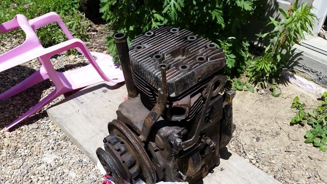

Picked up this today, block, crank, & head. Supposedly came from 1965 cadet. No I'd plates, maybe able to find some casting nos, etc later. Bore measured 3.250". Is this block same as ones used in WH's?

Hard to tell only from that view, but the first thing I notice is that it is missing one of the holes for mounting the PTO hardware.
How about taking some more pics at various angles.

Will this thing work in my 1056? Or just to bare and keep for parts?
rmaynard
Like I said, with only one picture from one view, it's hard to tell. My initial thought is to use it for parts. There are too many necessary parts missing, and you don't know the condition of the internals.

Will this fit a WH? Look at bottom pan
Shynon
That's a small pan block, you need a large base oil pan block for your 1056
