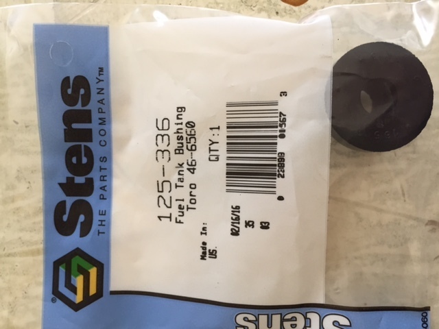

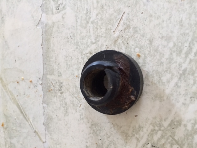

Screen was messed up. I removed it  Installed  a fuel filter. But had to get a new rubber grommet. Removed gas cap Still running the same. Removed carb Seems to be pretty clean in the bowl.  I will tear it apart and soak it in carb cleaning machine for a while. Gas line from the fuel pump to carb needed replaced anyway.

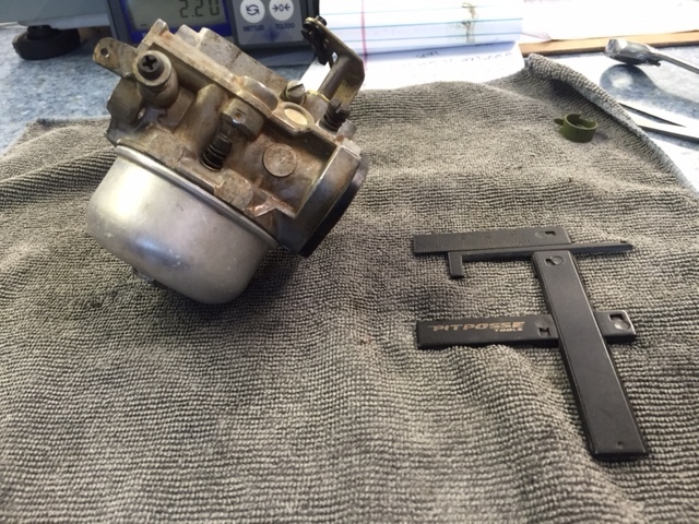

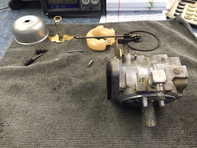

I got the carb torn down. Nothing like a motorcycle carb. :no:On a motorcycle when you have to run the engine with the choke. It's the low speed needle that has some on the holes plugged. I can see the main needle, but have no idea how to get to it.
TimH

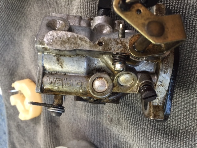

Looks like a walboro Carb Takes special tools to do a total service  ? Any advise ?

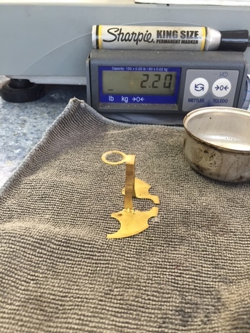

I see the pic of the brass spacer looks like it's broke Here is a better pic

Left in Altra Sonic Carb cleaner for 1 hour. Put it back together Made preset adjustments Now to re install on engine and see how it runs, FYI Goldwing and VTX carbs are a lot easier to clean  LOL.
