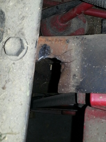

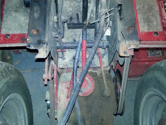

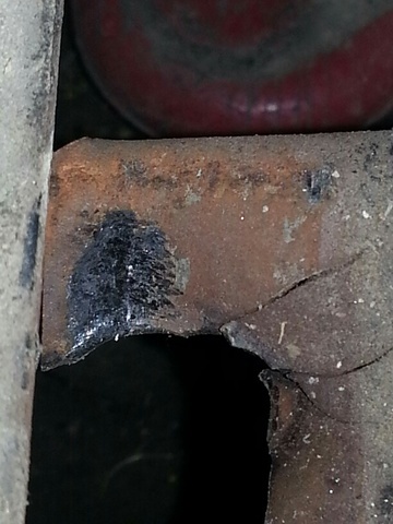

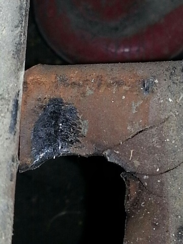

sluggo 40 #7 Posted August 9, 2016 This happened to me last month. The seat started feeling wobbly. I checked out this post, disassembled my tractor, and sure enough the bar holding the seat pan ripped off the frame. I got a guy locally to weld it it back together and working well. I agree, bad design. If can find pictures, I'll upload Share this post Link to post Share on other sites
sluggo 40 #8 Posted August 10, 2016 That steel tabs are probably only an 1/8" thick. You get 230lbs bouncing up and down in 3rd gear, stuff happens. Anyway, here are pictures that I promised. Like Ohio Farmer said, check the seat and seat pan integrity. 1 Share this post Link to post Share on other sites
