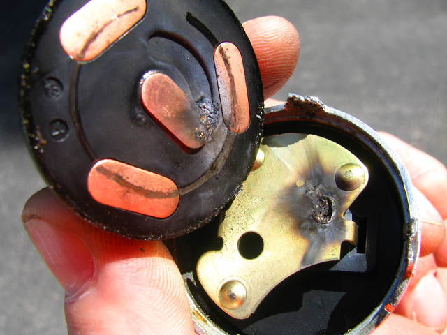

squonk 45,402 #3 Posted June 9, 2016 (edited) Would not be surprised if you burnt the switch up internally leaving the key on. I know it wasn't in the start position but the rotating contact is used in all the ign on posistions Edited June 9, 2016 by squonk Share this post Link to post Share on other sites
