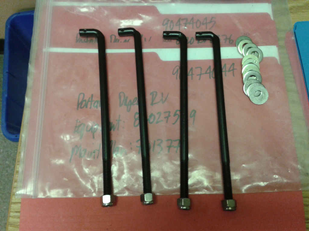

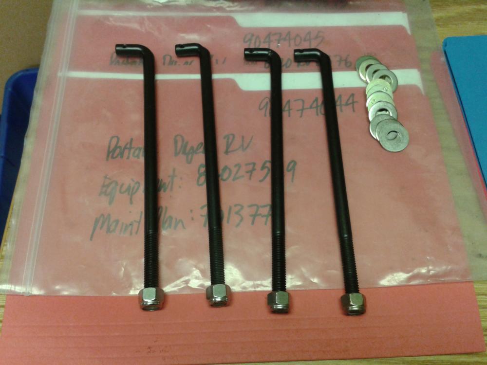

cleat 7,702 #2 Posted January 1, 2017 I made up a few rods just because I had time at work this weekend. I used the power pipe threader with a 3/8" thread die to cut the threads onto the rods. Cleat 2 Share this post Link to post Share on other sites
woodchuckfarmer 333 #3 Posted January 1, 2017 nice job. Share this post Link to post Share on other sites
lynnmor 8,105 #4 Posted January 1, 2017 Wheel Horse upgraded the rod to a heavier material. They also have instructions for using the upgraded rod on older decks. Share this post Link to post Share on other sites
cleat 7,702 #5 Posted January 1, 2017 My 60" deck has the 1/2" rod. The 3/8" seems to work OK for me on the 48" decks. Share this post Link to post Share on other sites
Terry M-(Moderator) 2,266 #6 Posted January 1, 2017 1 hour ago, cleat said: I made up a few rods just because I had time at work this weekend. I used the power pipe threader with a 3/8" thread die to cut the threads onto the rods. Wish I had the skills to do this....Nice work Cleat Share this post Link to post Share on other sites
