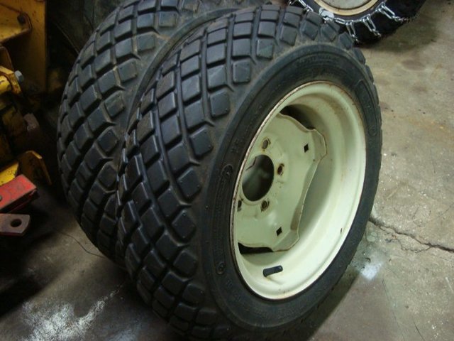

C-101plowerpower 1,606 #94 Posted July 19, 2016 On 17-7-2016 at 10:48 PM, wallfish said: So those of you who took the bike for a ride at the show probably noticed the lack of power. It was probably better for cruising around there anyway with all the tractors and people. Spent some time today checking things out and making some changes. That blue Kevlar drive belt which was slipping on the little 1 1/2 inch pulley was changed to a notched belt, made some adjustments to the torque converter and bypassed the governor. Quite the difference in power now! So if you thought it was a scary ride then, it's more fun now. More power and still difficult to steer with marginal brakes. It won't pop a wheelie (yet) but takes off pretty good. Not so sure I want to find the top end speed the way it is but will try and fix some things and maybe try by the end of the year. More mechanical leverage on the brake band should help the brakes. Front brakes might be a good idea too. Both tires need to be changed for higher speeds and a rounded edge front tire should help it steer better. Maybe one of those diamond thread tires would work on the front 2 Share this post Link to post Share on other sites
Horse46 519 #95 Posted July 20, 2016 On 19 July 2016 at 9:38 AM, C-101plowerpower said: Maybe one of those diamond thread tires would work on the front Do you mean the ATV type with the rounded edge? Share this post Link to post Share on other sites
C-101plowerpower 1,606 #96 Posted July 20, 2016 On 17-7-2016 at 10:48 PM, wallfish said: ^that wont go away Anyway i was thinking along these lines 4 Share this post Link to post Share on other sites
wallfish 20,231 #97 Posted July 20, 2016 6 hours ago, C-101plowerpower said: Anyway i was thinking along these lines I was looking for that exact thing while at the show. I was going to sneak a set of 6-12 AGs onto a RJ-58 that was parked near me and hope Jim didn't notice his diamond treads were gone 4 Share this post Link to post Share on other sites
WHX?? 57,470 #98 Posted July 20, 2016 Few more beers in me fish and I probaly wouldn't have!! I have been on the scout out for you tho .... Did we ever put some thing in the want classifies John ...there has to be a member that has diamonds laying around he doen't need ??? Share this post Link to post Share on other sites
