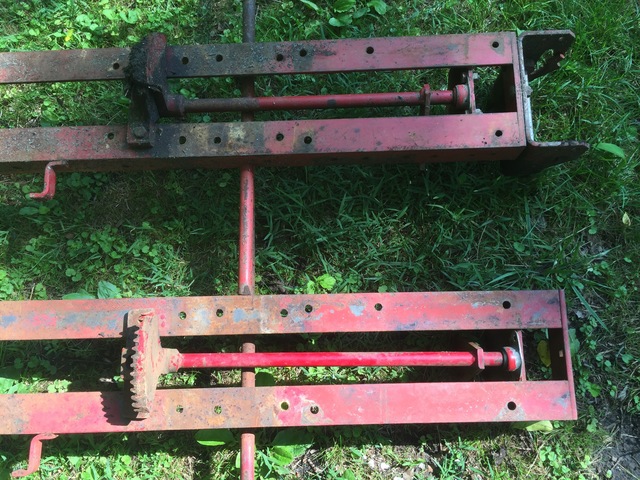

gwest_ca-(File Mod) 11,770 #1 Posted June 4, 2016 The transmission drive belts for these are 7478 which is the same as for the long frame C-Series models. I thought the B-100 was a medium frame length tractor. Is it possible they use the same belt? The frame part numbers are different. Garry Share this post Link to post Share on other sites
Racinbob 12,284 #2 Posted June 4, 2016 Interesting. The 74-75 B's are 43.5", the C's are 45.5". I was thinking maybe the pulleys were sized different.....nope, same part numbers. Checked the belt guard, same number. Is it possible that the extra length in the frame was in front of the motor? That would make the spacing between the motor and transmission the same. I'm thinking that's gotta be it. OK guys, get your tape measure out. 1 Share this post Link to post Share on other sites
KC9KAS 4,744 #3 Posted June 4, 2016 5 minutes ago, Racinbob said: That would make the spacing between the motor and transmission the same. I'm thinking that's gotta be it. That is what I was thinking. I would measure mine, but it is 30 miles away at my step-daughter's garage. Share this post Link to post Share on other sites
Racinbob 12,284 #4 Posted June 4, 2016 Don't let that stop you. Go measure it. Check this out. The lower steering shaft on the B is # 104886. On the C it's 104889. Something tells me the C shaft is 2" longer. Share this post Link to post Share on other sites
Bert 760 #5 Posted June 4, 2016 This might help, look at the engine bolt wholes. The frame, steering shaft, and hood are the only shorter parts, the rest is like the C 2 1 Share this post Link to post Share on other sites
Racinbob 12,284 #6 Posted June 4, 2016 Better than a tape measure. 1 Share this post Link to post Share on other sites
gwest_ca-(File Mod) 11,770 #7 Posted June 4, 2016 That explains it. The muffler appears to have a shorter elbow/pipe than the 1977 C-Series which would place the muffler closer to the engine. In 1975 the muffler for the B and C-Series was the same. Garry Share this post Link to post Share on other sites
