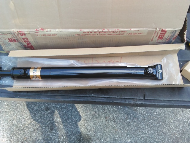

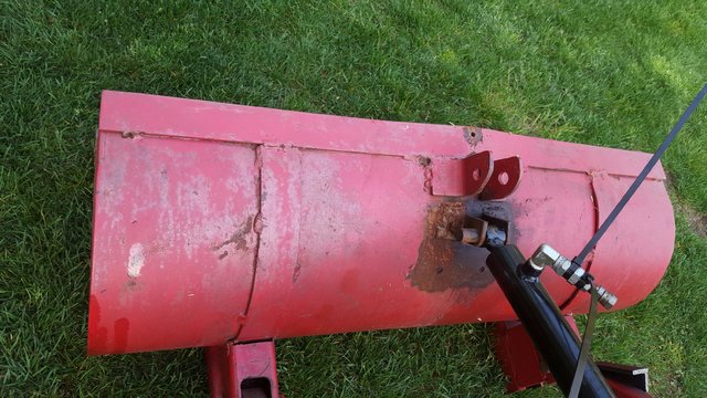

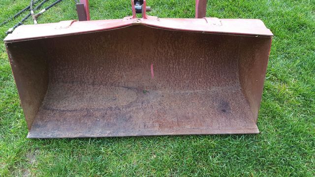

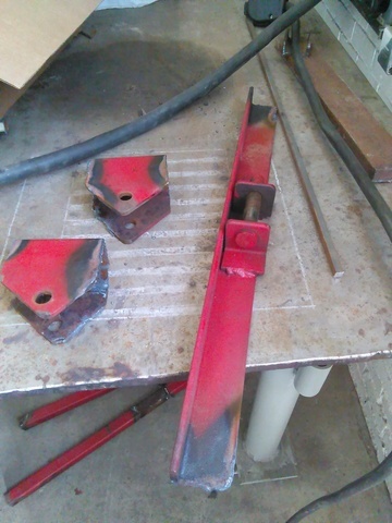

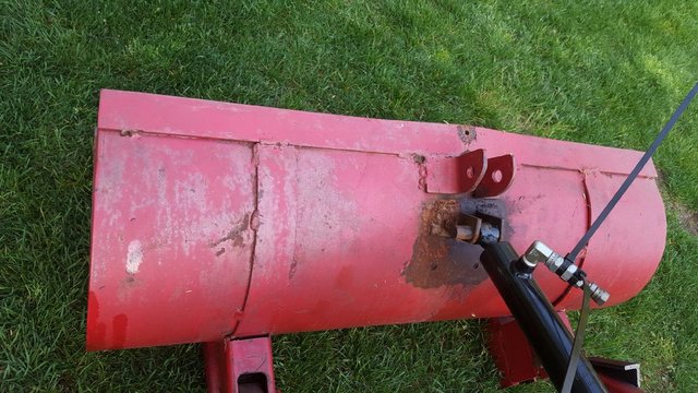

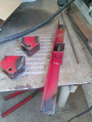

rexman72 210 #26 Posted June 23, 2016 ok great to know.here are some pics of the loader.We are building new arms for the loader and cut out some of the old parts.I ordered some cylinders to from the post you sent me. 3 Share this post Link to post Share on other sites

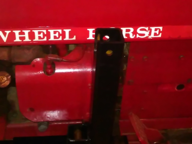

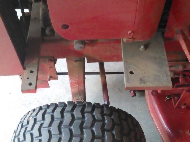

rexman72 210 #27 Posted June 23, 2016 this is the subframe attached to the tractor 2 Share this post Link to post Share on other sites

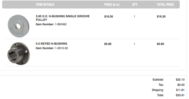

rexman72 210 #31 Posted September 18, 2016 On 6/3/2016 at 10:21 AM, WNYPCRepair said: Northern Tool has a few. I built my own loader with this pump and a 6" pulley, but it might be just a bit too powerful, the bucket moves a little faster than I would like. http://www.northerntool.com/shop/tools/product_200329712_200329712 this is the pump that I bought for my loader.The problem I am having is that I bought a pulley with a set screw that goes on the pump shaft and the set screw is to big and the pulley woobles on the shaft and the belt comes off.Is there a pulley you guys recommend that will fit on the shaft of this pump or should I try to modify the pulley I have to the pump shaft? Share this post Link to post Share on other sites
WNYPCRepair 1,923 #32 Posted September 19, 2016 (edited) 22 hours ago, rexman72 said: this is the pump that I bought for my loader.The problem I am having is that I bought a pulley with a set screw that goes on the pump shaft and the set screw is to big and the pulley woobles on the shaft and the belt comes off.Is there a pulley you guys recommend that will fit on the shaft of this pump or should I try to modify the pulley I have to the pump shaft? I did the same thing. That pulley will not work, you need these:http://www.mcmaster.com/#9859t1/=11w85ylhttp://www.mcmaster.com/#6209k215/=11w86up This is what I got, from surplus center Edited September 19, 2016 by WNYPCRepair 1 Share this post Link to post Share on other sites
rexman72 210 #33 Posted September 19, 2016 7 minutes ago, WNYPCRepair said: ok I am glad to know I am not the only one that had this issue.The one you have is 6 od for the pulley.Do they have a 4 to 5 inch pulley? I did the same thing. That pulley will not work, you need these:http://www.mcmaster.com/#9859t1/=11w85ylhttp://www.mcmaster.com/#6209k215/=11w86up Share this post Link to post Share on other sites
WNYPCRepair 1,923 #34 Posted September 19, 2016 1 minute ago, rexman72 said: http://www.surpluscenter.com/Power-Transmission/Pulleys/Split-Taper-Bushed-Bore-Pulleys/ I used the 6" because I used it on a loader for an XI series. The PTO pulley is about 6", so I wanted to be close to the same size. 1 Share this post Link to post Share on other sites
rexman72 210 #35 Posted September 19, 2016 4 minutes ago, WNYPCRepair said: http://www.surpluscenter.com/Power-Transmission/Pulleys/Split-Taper-Bushed-Bore-Pulleys/ ok I will be ordering this and thanks for the good info because I was trying to figure this out today 1 Share this post Link to post Share on other sites
WNYPCRepair 1,923 #36 Posted September 19, 2016 2 minutes ago, rexman72 said: ok I will be ordering this and thanks for the good info because I was trying to figure this out today All thanks go to Andy, without his help, I would not have been able to do as nice a job as I did on my loader. Share this post Link to post Share on other sites
