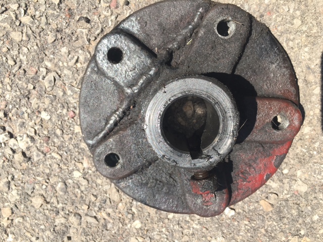

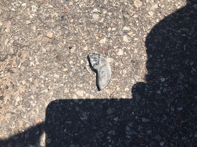

Deadguy 864 #12 Posted June 3, 2016 Here is what I found. The leyway in the axle looks great, the leyway in the hub is a little chewy, but should be serviceable for now, and a woodruff key with a big missing chunk. The hub had drifted inward on the axle, then the unsupported key surface drifted upward, and the little bit of key in contact with the hub sheared off. I have measured the axle, and it is 1 1/8" in diameter. Does this help identify the transmission and the size key needed? 2 Share this post Link to post Share on other sites
moe1965 774 #13 Posted June 3, 2016 Kinda looks like my issue I have now but my shaft is a 1 in. It got chewed up a little and measures .990. I'm having a friend turn me some new hubs Share this post Link to post Share on other sites
Racinbob 12,798 #14 Posted June 3, 2016 (edited) I think you'll be OK. Obviously the hub has been welded. It looks well done but it would bug me. The key is 1/4" wide x 1" long, radius height 7/16". You may want to install new seals while you have the hub off. Make sure you clean any burrs off before you slide the new seal on. It wouldn't be a bad idea to drill and tap for a second set screw 90 degrees off the existing one. Edited June 3, 2016 by Racinbob 2 Share this post Link to post Share on other sites

Deadguy 864 #16 Posted June 3, 2016 1 hour ago, Racinbob said: I think you'll be OK. Obviously the hub has been welded. It looks well done but it would bug me. The key is 1/4" wide x 1" long, radius height 7/16". You may want to install new seals while you have the hub off. Make sure you clean any burrs off before you slide the new seal on. It wouldn't be a bad idea to drill and tap for a second set screw 90 degrees off the existing one. Nope, this woodruff key is definitely larger than 1". Share this post Link to post Share on other sites
Deadguy 864 #17 Posted June 3, 2016 20 minutes ago, Deadguy said: Nope, this woodruff key is definitely larger than 1". It is 1 3/8" long, 1/4" thick, and 9/16" high with a flat bottom. Share this post Link to post Share on other sites
Racinbob 12,798 #18 Posted June 3, 2016 My apologies. The aging gray matter between my ears forgot about the transmission swap. It may be a good thing your hardware store is also a Toro dealer. 1 Share this post Link to post Share on other sites
Deadguy 864 #19 Posted June 4, 2016 2 hours ago, Racinbob said: My apologies. The aging gray matter between my ears forgot about the transmission swap. It may be a good thing your hardware store is also a Toro dealer. No worries! But the thing is, even though this is the supposed 8 speed, the part look up system said it used a 1" key. So that did not help. Then again, their system only went back to 1980, so it is possible the 1 3/8" key was discontinued before then. I ended up having to order a 10 pack of 1 3/8" keys from McMaster Carr . So, if anyone here needs a 1 3/8" key, I just may have an extra for you! 3 Share this post Link to post Share on other sites
