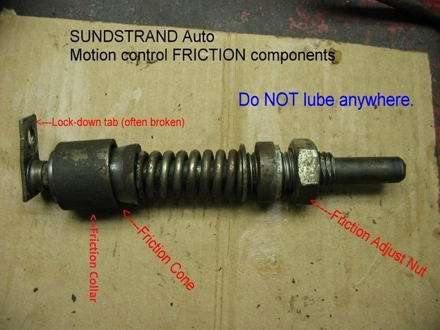

buffaloman 295 #4 Posted June 3, 2016 ok so it looks like loosing a lock nut and then turning that collar to tighten it back up Share this post Link to post Share on other sites
rmaynard 16,292 #5 Posted June 3, 2016 And use no lube on it. 1 Share this post Link to post Share on other sites

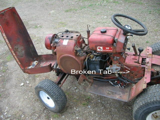

daveoman1966 3,839 #6 Posted June 3, 2016 (edited) If adjusting the tension on that friction collar and nut doesn't solve the problem, have a look at the left side of the hoodstand for a fairly common issue. If this lock-down tab is broken, the shift lever will slop around almost by itself. Edited June 3, 2016 by daveoman1966 2 Share this post Link to post Share on other sites
buffaloman 295 #7 Posted June 4, 2016 On 6/2/2016 at 11:47 PM, daveoman1966 said: If adjusting the tension on that friction collar and nut doesn't solve the problem, have a look at the left side of the hoodstand for a fairly common issue. If this lock-down tab is broken, the shift lever will slop around almost by itself. daveoman that is exactly what it was! thanks for the tip , you got any tips for fixing it ? 1 Share this post Link to post Share on other sites
