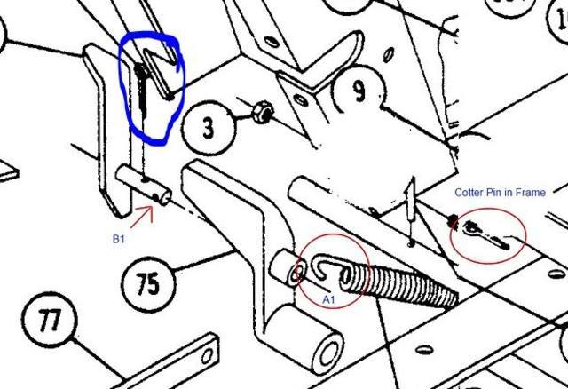

CasualObserver 3,417 #2 Posted June 2, 2016 (edited) The top of that spring should go through another cotter pin, see pic. I don't have an actual picture immediately handy, but I know there are some here on the forum somewhere. edit:.... found one. although the link credited is broken (pre-2011 crash) Edited June 2, 2016 by CasualObserver 1 Share this post Link to post Share on other sites
sscotsman 200 #3 Posted June 2, 2016 (edited) Thanks Jason! (the link you posted doesn't work..it did the thing where it replaced part of the link with just dots.. the three dots (periods) in "php?...pic" is supposed to contain more of the link.. could you try re-posting it please? But I think you have given me the clue I needed! I couldnt figure out *how* the spring came off in the first place! its a very robust spring, and seems very firmly attached.. but your mention of a second cotter pin explained it.. the spring fell off because the strength of the spring pulled the "front" cotter pin apart! the "front" cotter pin seemed a bit mangled as I removed it when I tried to re-attach the spring.. So now I know I need a new cotter pin for the front.. Also, I see now that I probably have the spring reversed.. I didnt notice it when I took the photo, but I can see it now: there is a "shadow" of the spring etched into the paint! and it looks like the "larger hook" end of the spring goes to the rear.. So I think I have it now..thanks! (I would still love to see other photos though, to confirm..) thanks, Scot Edited June 2, 2016 by sscotsman 1 Share this post Link to post Share on other sites
CasualObserver 3,417 #4 Posted June 2, 2016 The picture is actually from @buckrancher's 854 rebuild, if you're interested.... brian's 854 complete rebuild if there's not a pic below, go to page 4 of that topic. 2 Share this post Link to post Share on other sites
