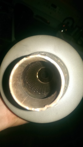

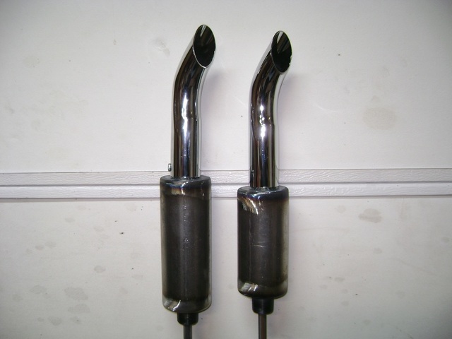

JPWH 6,542 #1 Posted May 29, 2016 I have been working on building a quieter stack muffler. After three muffler builds I have reduced the dB from 86 at wot to 78. All three mufflers run at 69 - 72 dB at idle. I have kept the size the same on each one 2.5" x 8". Using 1.5 od for the stack. This seems to give the best tone. 4 Share this post Link to post Share on other sites

JPWH 6,542 #3 Posted May 29, 2016 Pictures coming soon. I am using my k181. 2 Share this post Link to post Share on other sites
jimkemp 527 #4 Posted May 30, 2016 if you go with a 3" muffler body you can lower the db level , also the holes in the center baffle make a big difference , smaller holes make less db 4 Share this post Link to post Share on other sites

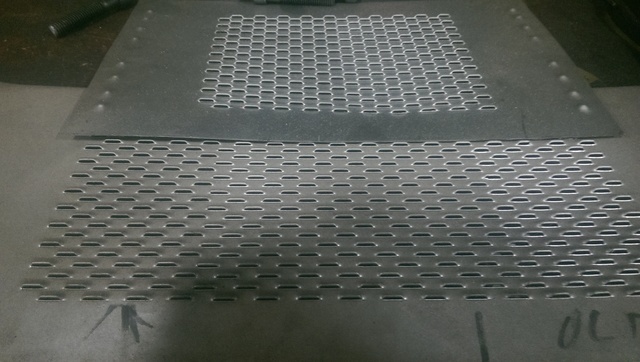

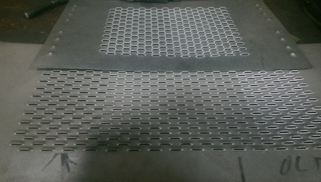

WVHillbilly520H 10,376 #5 Posted May 30, 2016 I say put a "Walker" muffler on there and keep a hillbilly at work, anyways working there for 19+ years there are a few different approaches to tuning the db/sound, the baffling also called "louver" tubes have louvers punched in them small to large straight pattern or opposing, then steel wool or high temperature fiberglass packing/wrap, then straight through flow design or internal partitions to divert exhaust flow inlet to outlet in an "S" pattern, then chambered so it's all experimentation till you get what you want, then there's Supertrapp brand where you add or take away discs to change sound/db levels,Jeff . (Louver tube in a muffler) 6 Share this post Link to post Share on other sites

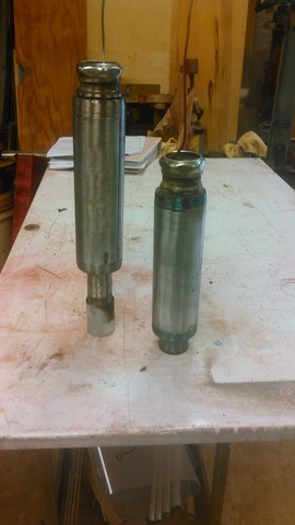

JPWH 6,542 #6 Posted May 30, 2016 2 ready for paint. 3 Share this post Link to post Share on other sites

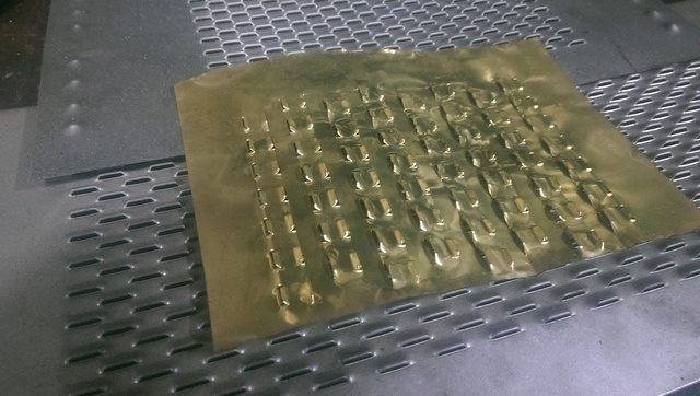

WVHillbilly520H 10,376 #7 Posted June 3, 2016 Some pics of the "louver" patterns for mufflers, the silver aluminized is a standard single direction flat louver and the gold brass is an unidirectional double flat (more aggressive tone), then there's perforated (round holes punched/drilled) tubes like used in high performance mufflers (no pic),Jeff. 1 Share this post Link to post Share on other sites
