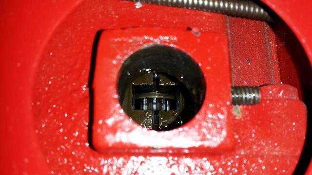

Racinbob 13,117 #4 Posted May 26, 2016 (edited) That's a good explanation on how to do it. Make sure your shifter forks are in the neutral position (use a screwdriver). They will look like this. Tighten the setscrew just until you start feeling resistance as you shift through the gears. Then back off just a fuzz and hold it there as you tighten the lock nut (not shown in the picture) Edited May 26, 2016 by Racinbob 2 Share this post Link to post Share on other sites
