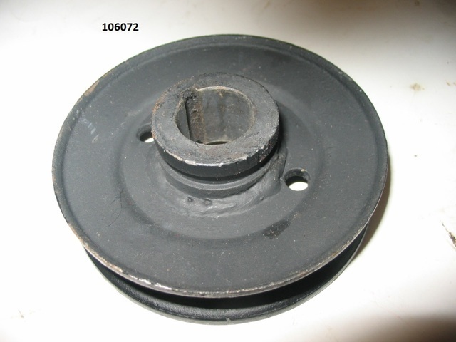

daveoman1966 3,880 #7 Posted May 25, 2016 Those pulleys with a woodruff key USUALLY have a 'rim" on the top edge of the pulley...at least the side pulleys do. This 'rim' is used to pull off the pulley by using a Power Steering Pump Pulley Remover Tool that is available ON LOAN... from Auto Zone. You pay for the tool when you take it, then get a 100% refund upon return. Here is a look-alike pulley... this is for the 42" side disch mower deck. ps... if you need these pulleys, lemme know. Share this post Link to post Share on other sites
elcamino/wheelhorse 9,362 #8 Posted May 25, 2016 Thanks for the information, just an FYI you can purchase the power steering pump pulley Removal tool from HF . I think I paid about $19.00 for mind has a wide variety of sizes. Dave Again thanks for your information it is very helpful. I have a 42 deck I bought for parts I need to take a look at it to see if I need any pulleys. I am going to print this and keep in my info. note file. Share this post Link to post Share on other sites
