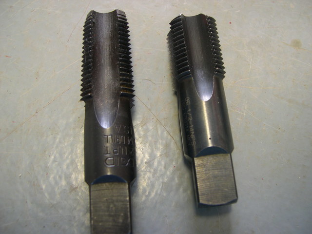

WVHillbilly520H 10,376 #26 Posted May 29, 2016 19 minutes ago, stevasaurus said: I am not positive on your transmission...about the closed and open bolt holes. Usually the top bolt holes are open into the trans, and the bottom ones are closed. There is a term for that, but it escapes me now. Closed hole = "blind" hole which would use a "bottoming" tap open hole= "through" hole which would be a starter or "gun" tap...and if you're going to remove transmission one could just "fill" the stripped hole with "weld"(have to be really careful with cast iron) redrill and tap is one of our long term fixes at work also there are better thread repair inserts on the market but you still have to drill bigger to install, "Gardsert" hardened thread inserts for 1, EZ LOK another, are some we use at work on industrial machinery,Jeff. 3 Share this post Link to post Share on other sites
Racinbob 11,945 #27 Posted May 29, 2016 (edited) I think the term you're looking for is blind hole. I like the idea of re-tapping for 7/16". There's a lot of stress on those 4 bolts. I would do all 4 just so they are the same. I would open the case but if you're careful you should be fine not doing so. On the bottom blind holes start with a taper tap (left) and finish up with a bottoming tap (right). Sorry WV, typing at the same time. Edited May 29, 2016 by Racinbob 5 Share this post Link to post Share on other sites

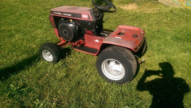

howell1000 35 #37 Posted May 30, 2016 Thanks guys its the top right hole if your sitting on it I dont have a good place right now to do alot of work . How much would a half of case run?? and you think if I watch the oil level it could get me through summer till i can start a redo ?? Share this post Link to post Share on other sites

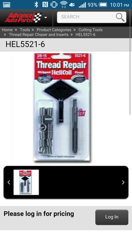

WVHillbilly520H 10,376 #38 Posted May 30, 2016 I think if you used the Helicoil and Loctite and yes kept watch on the fluid and the other 3 were good and your yard isn't to bumpy and stressful on your frame, yeah you "should" be ok till complete tear down and fix, like I said before temporary fix at best but something is better than nothing,Jeff. 2 Share this post Link to post Share on other sites
howell1000 35 #39 Posted May 30, 2016 Thanks jeff my yard is bumpy in spots I just dont want to get into something that will take along time to fix and my yard turns into a hay field were is the best place to pic up a Helicoil?? Share this post Link to post Share on other sites
WVHillbilly520H 10,376 #40 Posted May 30, 2016 (edited) Auto parts stores, NAPA or Advance Auto and such, sometimes they come in a kit with the "chasing" tap and install tool too,Jeff. Edited May 30, 2016 by WVHillbilly520H Share this post Link to post Share on other sites

Racinbob 11,945 #42 Posted June 3, 2016 (edited) Now I'm befuzzled. I was going with the flow on this thread without another trip to the garage to verify but I just had to check it this morning. I've got an open case out there (3900 & 3901) All four holes are blind. You're saying it's the top right hole so I'd say you's getting seepage from the hole where you install the shift stop balls/spring/pin. That's near the top right bolt. Edited June 3, 2016 by Racinbob Share this post Link to post Share on other sites
howell1000 35 #43 Posted June 3, 2016 there is four holes as i can tell i have not took anything apart to really look good two in bottom two in top i took the one out of the left side to match up at store because i thought one was missing got home put the one on left back in went to put the one on right back in and nope would not even start i tried for half hour i would think it started and then it would just fall out. 1 Share this post Link to post Share on other sites
Racinbob 11,945 #44 Posted June 3, 2016 You need to pull the tranny so you can get to things. I think you should drill and tap to 7/16" as I mentioned before. I took another look at the one I have open and there's plenty of meat there. Get the correct bit and you'll feel it bottom out. Taper tap then bottom tap. You won't have to worry about shavings. You'll need to drill out the holes in the frame plate too. Easy, peasy. 1 Share this post Link to post Share on other sites
howell1000 35 #45 Posted June 4, 2016 Thanks i need to find time between mowing this is only tractor i have Share this post Link to post Share on other sites
