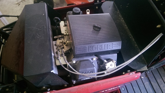

fatboycowen 31 #1 Posted May 24, 2016 My 518xi runs great, and starts very easily when cold. However, lately, if i start it hot, it's somewhat difficult to start. Takes a bunch of cranks and just the right throttle position. Once it starts it runs a little rough at first, at mid throttle. Full throttle is fine. Where should i start? My research suggests it could be: vapor lock (haven't tried loosening the cap yet, will next time i mow) A weak coil. Not sure how to check. I haven't pulled the plugs lately, so i may do that. Valves out of adjustment causing weak compression when hot - are these valves adjustable? This is the first gas motor that i have yet to mess with the carburetor on, so that might be something to check. thoughts? Thanks. Jon Share this post Link to post Share on other sites
WVHillbilly520H 10,376 #2 Posted May 25, 2016 We'll start cheap and easy spark plugs first ,how may hours on that machine? About every 200 or so hours replace them and yes that Kohler with over head valves are adjustable rather easily from the top kinda like a car with little valve cover on either side of the air cleaner (in the picture) which should also be ckecked and cleaned and or replaced new again 200 hr intervals or less if really dusty the valve adjustment is likely 500 hrs but check the manual if you don't have one they can be downloaded from here by using the search feature,Jeff. 1 Share this post Link to post Share on other sites
