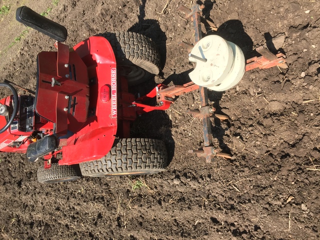

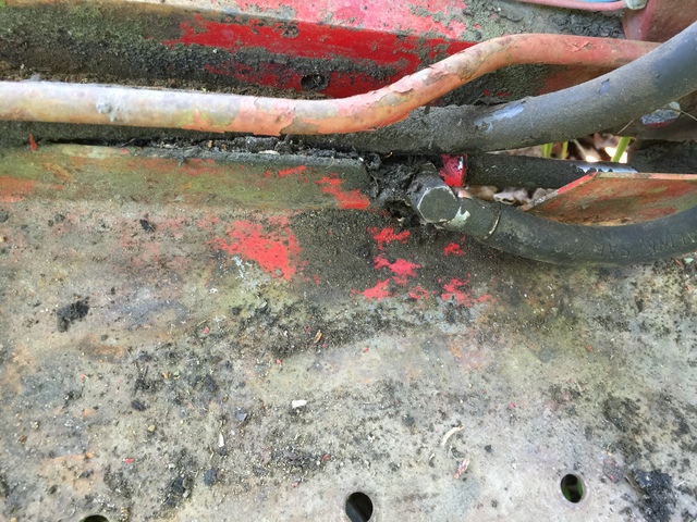

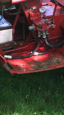

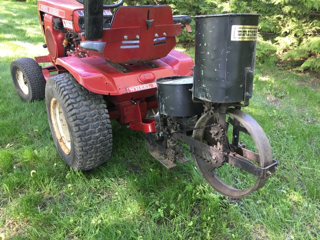

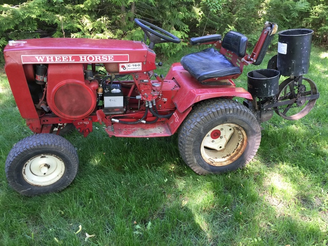

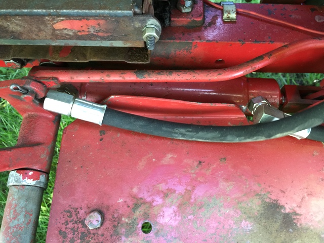

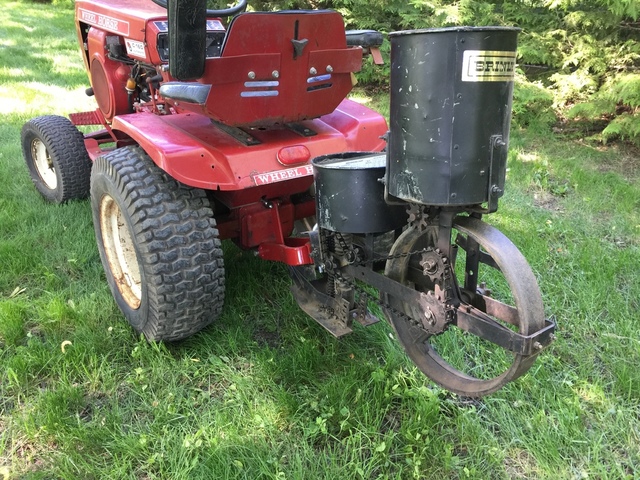

wheelhorseman 3,251 #1 Posted May 22, 2016 My 1974 C-160 that I bought last year leaked lots of oil every time I would move the cylinder- between the hoses and cylinder I don't know which one leaked more - so I rebuilt the welded together hydraulic cylinder and I made new hydraulic hoses for it. I think this is now my favorite C-160 (I better not say that to loud the other C-160s will get jealous) Now it is dry as a bone and I know how you guys love pictures so here some pictures of it in action. 10 Share this post Link to post Share on other sites

pfrederi 19,936 #6 Posted May 22, 2016 The hose fittings you used SAE5 ORB or SAE6 ORB. (If SAE5 where did you find them???) 1 Share this post Link to post Share on other sites
wheelhorseman 3,251 #7 Posted May 22, 2016 (edited) Yes I would be interested in rebuilding more welded together cylinders or any cylinders for that matter. I would like to find a few more junk ones to have as cores so if anybody has any junk ones please let me know by PM or call or Email 507-213-6346 wheelhorseman@hotmail.com 8 minutes ago, pfrederi said: The hose fittings you used SAE5 ORB or SAE6 ORB. (If SAE5 where did you find them???) I found them in my shop the cylinder hoses are #5s and the hoses from the pump are #6s~ I am now offering hydraulic hoses for sale in the venders section Edited May 22, 2016 by wheelhorseman1000 5 Share this post Link to post Share on other sites
