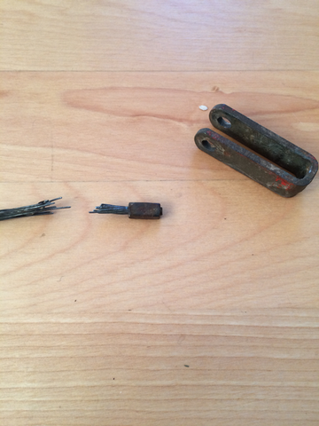

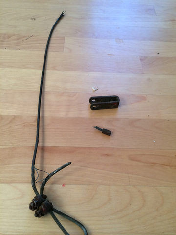

Hi folks--first post on this forum.  I have a Raider 10 and have been using a tiller attachment.  This morning I snapped the rear lift cable.
I have no idea how to fix this!
I've had the tractor for about 3 months and am just still getting to know it.
Help!

Look in the vendor section. Wheelhorseman 1000 has them.

You could also make one. The cable is available at Lowes,Home Deot, or maybe your hardware store. Instead of using the clevis, loop it thru the clevis hole and secure with clamps, just like the back.
