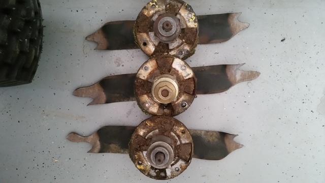

Racinbob 12,794 #9 Posted May 25, 2016 Here's the blades and spindles I removed from the kids green and yellow thingy a couple weeks ago. 1 Share this post Link to post Share on other sites
WHX?? 55,120 #11 Posted May 25, 2016 Yikes Bob they look like some kind of medieval death weapon!! 40 minutes ago, gwest_ca said: At one time many manufacturers supplied what they called a sand blade but you don't see them any more. In sandy areas the lift picks the sand up and as it exits the blade it takes some metal with it. I thought thats what gator blades were Garry?? Or so I was lead to believe by the guy who sold me the last set? 1 Share this post Link to post Share on other sites
Racinbob 12,794 #12 Posted May 25, 2016 I think that's what they were Jim. All those edges were razor sharp. Just barely brushing them would draw blood. That's definitely do-say. On top of that the noise the spindles made was deafening. The blades on my Wheel Horse hold up a lot longer. I think that's mainly because they don't spin nearly as fast. I would like to find some of those sand blades Garry mentioned. Share this post Link to post Share on other sites
