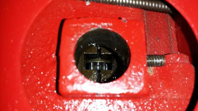

Racinbob 12,804 #2 Posted May 20, 2016 The first thing you need to do is remove the shifter. Look down the hole and you'll see the shift forks. Use a screwdriver and slide them until they look like this. Replace the shifter with the ball at the end in the rectangular hole making sure the dogpoint setscrew goes in the hole in the front of the ring. Tighten the setscrew until some resistance is felt as you shift through the gears then back off a fuzz and tighten the locknut holding the set screw in place as you do so. If that doesn't fix it, get back to us. . 4 Share this post Link to post Share on other sites

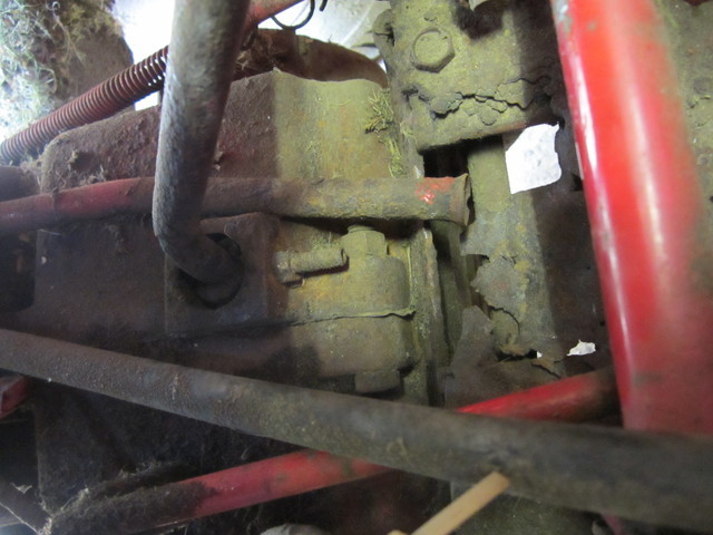

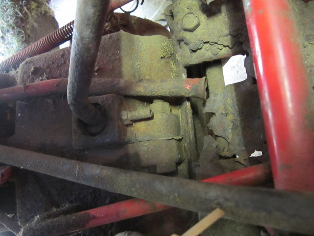

Keith UK 6 #8 Posted May 21, 2016 OK guys. Thanks for the friendly welcome and the advice. I've now finished cutting the grass, I'v had my warm beer and I've started in the garage to adjust the "shifter". As I am not used to keyhole surgery can you tell me what the size of the lock nut is as 7/16"AF doesn't seem to fit snugly. Also it looks as though the stud that holds the shifter in place might have an Allen key slot in the end. Is this right and what size is it? Sorry to ask what you might feel are stupid questions but I just can't get my head and hands down the hole to see everything properly and I'm sure you know the answers! Keith Share this post Link to post Share on other sites
stevasaurus 23,620 #9 Posted May 21, 2016 The nut should be a 7/16" and the Allen head set screw is 1/8". If you have a long Allen wrench, you should be able to come at it from under the frame. The dog point on the other end of the set screw goes into the front hole in the shifter ball. Tighten the set screw until snug, then back off about 1/4 turn. Hold in place and tighten the lock nut. That set screw looks long, but that is OK. I would not think they are metric...they should not be. 1 Share this post Link to post Share on other sites
Keith UK 6 #10 Posted May 21, 2016 Thanks Stevasaurus. It is now soaking in penetrating oil as the nut is reluctant to move with an open ended spanner and I can't get a ring spanner on it. Share this post Link to post Share on other sites
stevasaurus 23,620 #11 Posted May 21, 2016 Is the shifter sloppy?? One thing is for sure...do not snap off that set screw !!!!!! It is hardened and is not easy to drill out if it snaps. Soak it good. Did you try a metric on the nut...maybe an 11 or 12?? I have a little pipe wrench that gets in there and works good. 1 Share this post Link to post Share on other sites
