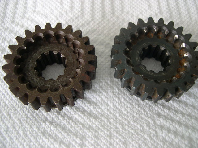

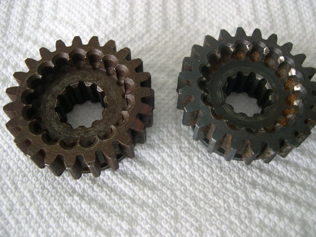

Racinbob 12,510 #4 Posted May 18, 2016 Here's the gear (part #3523) prondzy is talking about. The one on the left is new, the right is worn some but should be OK. This is a weak spot in these transmissions. The internal teeth link to the input teeth in 3rd gear. You can see that they are just about screaming "grind me down". You need to make sure the input shaft/gear (#3522) are in good shape as well. Running with no belt guard or an improperly adjusted one is a definite no-no. It didn't help any that, in the earlier years, Wheel Horse stated in the manuals that you should depress the brake/clutch pedal half way when shifting while moving. 4 Share this post Link to post Share on other sites
