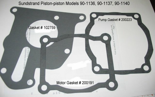

daveoman1966 3,881 #2 Posted May 18, 2016 I use the brand name FELPRO for gasket material. Take a small piece of the original gasket to any auto parts store to get the correct thickness. The material is made of strong non-porous material, just like OEM. You MAY be able to buy new gaskets on-line....here they are: 4 Share this post Link to post Share on other sites

daveoman1966 3,881 #4 Posted May 18, 2016 not ever. Just be sure to thoroughly clean the mating surfaces. Skim coat with gasket sealant. Share this post Link to post Share on other sites
