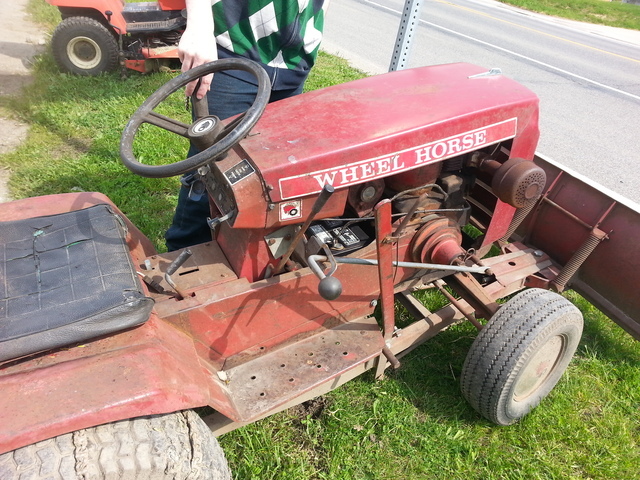

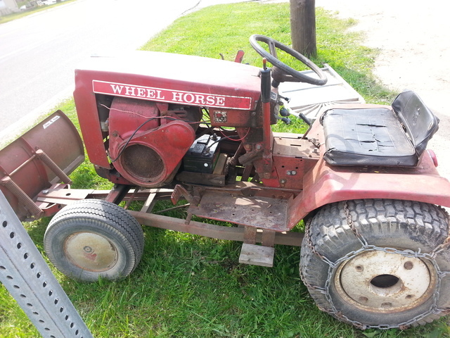

rj24 38 #1 Posted May 17, 2016 Hello I fond a wheel horse for seal he wants $450 for and I don't know what year or modal it is hope you can help me if you are in Indiana near Kendallville on us6 here the picture and will it be woth that much money 1 Share this post Link to post Share on other sites

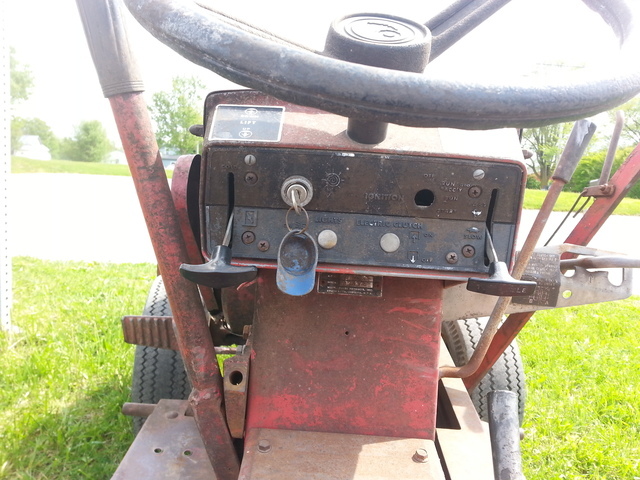

WVHillbilly520H 10,376 #2 Posted May 17, 2016 (edited) Looks to be a 70's-80's "B" or "C" series...if starts, runs and moves it should be worth it but doesn't hurt to offer less and work up to his asking price...does it have a mower deck? and what HP is it 8,10,12? I'm sure more knowledge will chime in soon looks like someone has done some wiring and moved the ignition switch try $300 ,Jeff. Edited May 17, 2016 by WVHillbilly520H Share this post Link to post Share on other sites
rj24 38 #3 Posted May 17, 2016 (edited) thanks this guy has no cloud what it is he a wheel and dealer no you i see and you see is what it has Edited May 17, 2016 by rj24 Share this post Link to post Share on other sites
roadapples 6,985 #4 Posted May 17, 2016 By 72 they were using the newer type starter, so it`s older than that. Snow plow and wheel weights help the price. Check the frame were the trans. mounts. Pushing snow is hard on that part of the frame. Not that hard to fix but will bring the price down... Share this post Link to post Share on other sites
rj24 38 #5 Posted May 17, 2016 Ok thanks for the tip Share this post Link to post Share on other sites
AMC RULES 37,237 #6 Posted May 17, 2016 Like the billy above... I'd be all done, maxed out at three hundred. 1 Share this post Link to post Share on other sites

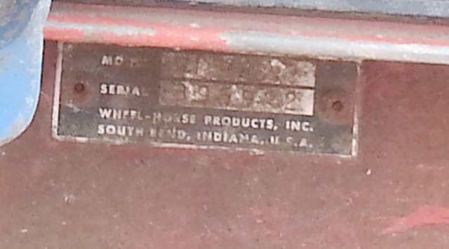

rmaynard 16,611 #7 Posted May 17, 2016 It has to be a '71 or earlier. The ID tag is under the dash. In 1972 they started putting it on the left side. If anyone can enhance the tag, we would know what we are dealing with and better estimate a value. 2 Share this post Link to post Share on other sites
Racinbob 12,284 #8 Posted May 17, 2016 (edited) I'm thinking it's a collection of years. The hood and steering wheel scream mid 70's, The motor and seat are earlier. Looking closely I think I see that the hood is raised in the front indicating it started out life as a 1974 C-160 with the Tecky and they put the Kohler on it. rj24, could that tag read 1-0385? Oops, wait.....the 1-0385 was an 8 speed. I'm back to a collection of years and owned by an elderly gentleman that needed a lower step in order to get on it. Edited May 17, 2016 by Racinbob 3 Share this post Link to post Share on other sites

rmaynard 16,611 #10 Posted May 17, 2016 The '68 Chargers had a different hood. I think it has been cobbled together from many different species. If @rj24 can get the ID number for us, that would be great. 2 Share this post Link to post Share on other sites
Terry M-(Moderator) 2,266 #11 Posted May 17, 2016 55 minutes ago, rmaynard said: If @rj24 can get the ID number for us, that would be great. ..rj24, Maybe You could just read/type up the Id numbers right off the tag.../ Share this post Link to post Share on other sites
WHX?? 53,076 #12 Posted May 17, 2016 68 or 69 for sure, take some spit and see if you can't wash off that tag a little... 300 at the very tops Share this post Link to post Share on other sites
TDF5G 2,073 #13 Posted May 17, 2016 3 hours ago, rmaynard said: It has to be a '71 or earlier. The ID tag is under the dash. In 1972 they started putting it on the left side. If anyone can enhance the tag, we would know what we are dealing with and better estimate a value. I think you are correct. The hood has been swapped out, the decals are the '73-77 ones and notice the paint on the hood doesn't match the rest of the tractor. Share this post Link to post Share on other sites

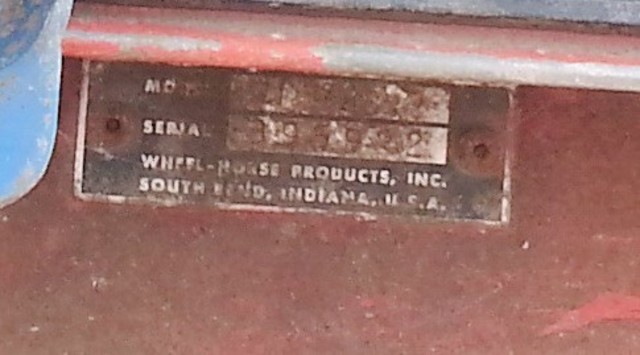

rj24 38 #14 Posted May 18, 2016 Here's what I got17395922 Share this post Link to post Share on other sites
rmaynard 16,611 #15 Posted May 18, 2016 I think you are missing most of the top number. The bottom number is the serial number, and the top number should read something like 1-XXXX. Share this post Link to post Share on other sites
rmaynard 16,611 #17 Posted May 18, 2016 If you stare at it long enough, numbers will appear, just like those computer generated pictures that some people can see and others can't, but when you stare at them long enough, cross your eyes, and let your brain go out of gear, a 3D image appears. I have stared at the image here for hours and now and have gone cross-eyed, but I now see 1- 7231. That would be an early model 1968 Charger 12, with a Kohler k301S-4712B which had a starter/generator and Sunstrand transmission. The hood is a '72 to '75 replacement, and the soft steering wheel is also a replacement. Just my worth. 3 Share this post Link to post Share on other sites
