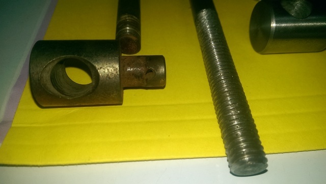

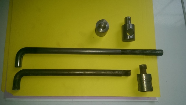

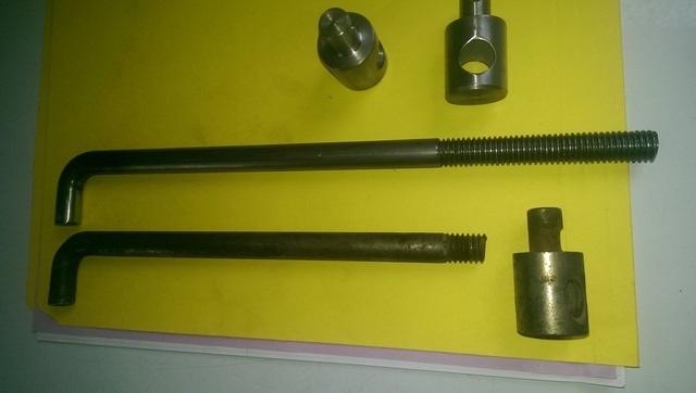

WVHillbilly520H 10,377 #1 Posted May 13, 2016 When I was cleaning up the Good Friday 520H and deck I found that the mower wouldn't come up to the highest setting in the quadrant, the leveling rod was broken off short and the trunion was woren badly, so to get mowing I borrowed the 1 off my '97 deck, so I decided to make a new rod 3/8" diameter by 9" lg threaded 3/8"-16 for 2.25" and a 90° bend 1" lg then the trunion (made 2) 3/4" diameter by 1.4" lg turned 1 end down to 3/8" diameter by 1/2" long and drilled 25/64" hole 3/8" center from big end for rod,cheaper than TORO replacements, Jeff. 4 Share this post Link to post Share on other sites

DougC 2,643 #6 Posted May 13, 2016 I have one break about every two years on my 95 520H, always in the same place in the threads. I keep an extra new rod and lock nut in my toolbox for the next certain failure which always seems to happen on a Saturday afternoon or Sunday when the Toro dealer is closed....... 1 Share this post Link to post Share on other sites
WVHillbilly520H 10,377 #7 Posted May 13, 2016 I have the '97 (by serial #) anniversary model new since '98 and knock on wood ,hasn't failed yet, and I borrowed it for the '95 till I made the new 1, both trunions were "worn" though that's why I made 2 of those, but 9" of 3/8" cold rolled steel rod a 3/8"-16 threading die a propane torch and 1/8" drill bit could have you back up and running in a pinch,Jeff. Share this post Link to post Share on other sites
lynnmor 8,316 #8 Posted May 13, 2016 The last couple of years those parts were made stronger. I have one of each. Share this post Link to post Share on other sites
gwest_ca-(File Mod) 11,901 #9 Posted May 14, 2016 Revised 1/2"-13 rod and nut Garry 1 Share this post Link to post Share on other sites
