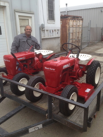

953 nut 62,135 #2 Posted May 12, 2016 (edited) The sheet metal and front axle are the primary differences, the 551 Suburban was the first to go away from the three piece transmission. Lots of subtle differences but they were both the same basic size and configuration. RJ on the left and Suburban on the right. (no, they are not mine) They belong to @Alfonso Edited May 12, 2016 by 953 nut 5 Share this post Link to post Share on other sites
AMC RULES 37,232 #3 Posted May 12, 2016 The logical evolution... of basically, the same tractor. 2 Share this post Link to post Share on other sites
Coadster32 793 #4 Posted May 12, 2016 The steering was a big change for the better as well. The RJ's steer very quickly. 2 Share this post Link to post Share on other sites
