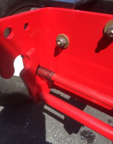

Aldon 4,828 #1 Posted May 11, 2016 Are the retaining clips in the attach-a-matic assemblies? Like the one retaining the spring in pic? I need a few and I have a box with standard sizes and none fit. Share this post Link to post Share on other sites
doc724 925 #2 Posted May 11, 2016 My experience is that they are standard sizes. I needed a few in my C141 restoration. Brought the old ones to the hardware store and matched them to the ones in the box. As I recall, the clips are sized by the shaft, not the groove diameter. If my memory is correct, you want one for a 1/2 inch shaft 2 Share this post Link to post Share on other sites
ztnoo 2,300 #3 Posted May 11, 2016 Retaining Rings and E-Clips http://catalog.automotivefasteners.com/category/non-threaded-fasteners-retaining-rings-and-e-clips Measure the outside diameter of the shaft, not the groove. http://catalog.automotivefasteners.com/viewitems/non-threaded-fasteners-retaining-rings-and-e-clips/retaining-e-clips 1 Share this post Link to post Share on other sites
Aldon 4,828 #4 Posted May 11, 2016 (edited) Found them. 7/16 CORRECTION THEY may be 5/16.....I think I erred originally. one of a few standard sizes not in my parts kit.... gonna have to order a bunch to store for when I need them.... Edited May 17, 2016 by Aldon 1 Share this post Link to post Share on other sites
