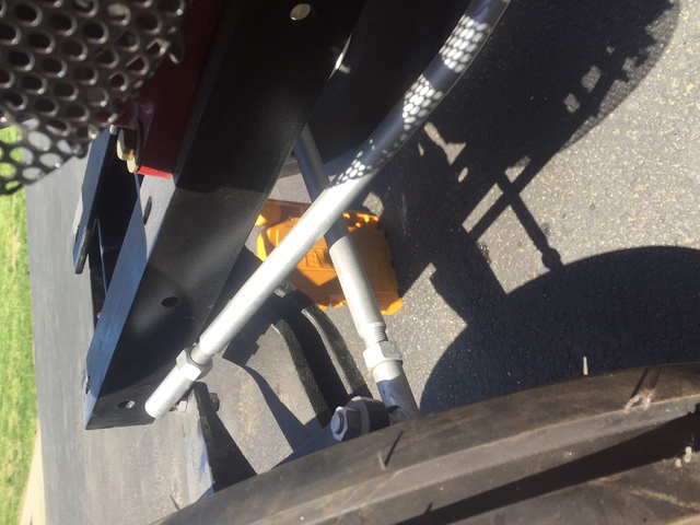

Aldon 4,830 #4 Posted May 11, 2016 2 hours ago, 953 nut said: I came up with some that were listed for John Deere on agrisupply.com that had the correct female thread, but I had to drill out the steering arm for the larger male threaded end. I seem to recall some one on here posting that McMaster-Carr had a direct replacement, just need to look it up by thread sizes. I managed to find that same set up in Amazon. I was waiting for one of our vendors to reply as to whether he had the original style set-up and he suggested same path as you ended up taking. Guess I'll proceed similarly. As I have no loader it seems a non issue strength wise. Share this post Link to post Share on other sites

Aldon 4,830 #6 Posted May 12, 2016 11 minutes ago, swisstrac said: great info ; as i just ordered the wrong tie end; thanksmuch Aldon for info re McMaster-Carr, Can you point me in right place to order same ? rgds ray Ray, Easier way to get the right ones is to order from site vendor @wheelhorseman1000 . See the vendor section. He indicated he was ordering them to his stock tomorrow. There are 4 ball joints total on the Gt14. 3 of the larger type and one of standard type where it connects to the steering fan gear. At least that's the way the several I have had are configured. So you will need to drill out the spindles where ball joints attach to accept the 7/16 inch post or bolt. So it's 7/16 male and 1/2 female. Qty 3, and Qty 1 3/8 for fan gear....if I'm correct. Better double check though:-) BTW, how's your rebuild coming along? 2 Share this post Link to post Share on other sites
