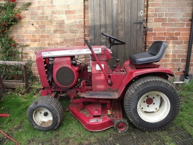

Philip Parry-jones 26 #1 Posted May 11, 2016 After watching a church groundsman mowing around the tombstones with a Stiga mower and talking to him it looked as if I NEEDED a Stiga mower.After bidding for a few on ebay I finally got one.Yes it did get into corners but even though it was meant to be 13.5 HP it would not cut long grass like my C101 which has a 10HP Kohler,it was unstable on slopes and the wheels spun on inclines.Luckily my C101 has not been sold so I am now giving it a bit of care before putting it back into use.I really need a set of new blades but as I have welded and painted the deck I do not have a part number for them.The deck is a 36" tachamatic rear discharge type and the blades are two at 12" long and one at 14" long,I have not been able to find the number in the manuals section,does anyone know which blades I need?.And the Stiga? sold on ebay and only lost £10,an expensive error,learn by my mistake,red mowers NOT yellow!. 2 Share this post Link to post Share on other sites

Philip Parry-jones 26 #7 Posted May 11, 2016 Feel ashamed at being seduced by the swedish stiga! the wheel horse has been a loyal friend for many years.Moving trailers,pulling boats up the slipway and of course cutting the grass.She seems to have forgiven me. 5 Share this post Link to post Share on other sites
TDF5G 2,073 #8 Posted May 11, 2016 The old girls can be very forgiving! Share this post Link to post Share on other sites
gregg'shorses 77 #9 Posted May 11, 2016 Treat her to an oil change and a fresh air filter. Share this post Link to post Share on other sites
Philip Parry-jones 26 #10 Posted May 12, 2016 Promised her some new tyres!. Share this post Link to post Share on other sites
Retired Wrencher 6,468 #11 Posted May 12, 2016 Philip Parry- jones. They where made to last a life time. If you do the P.M.`s I always said if take care of them they will take care of you. 3 Share this post Link to post Share on other sites
