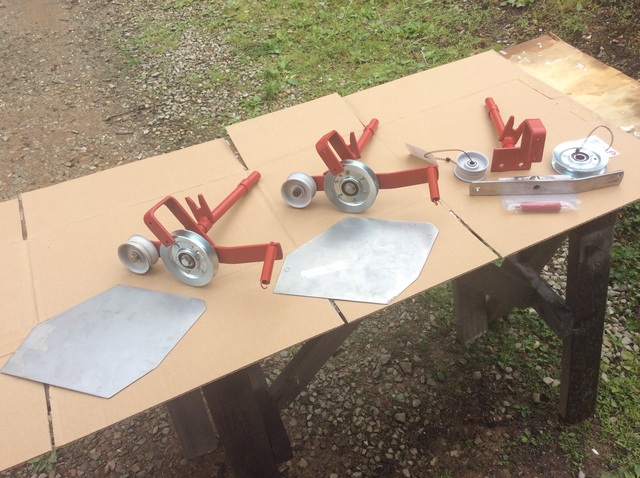

WHX?? 55,120 #4 Posted May 9, 2016 Mid idler would be the assembly that's fits in the miidle right side attach bracket.and strings the belt waaaaay back to the tiller. Not the worst price if in decent shape like doc says says.It might fit a 520 but would need the model to be sure. Share this post Link to post Share on other sites
312Hydro 474 #5 Posted May 9, 2016 (edited) That will fit a 520h. Here is a pic of the mid mount idler. You can easily make a variation of one,just do a search on the forums Edited May 9, 2016 by 312Hydro 2 Share this post Link to post Share on other sites
