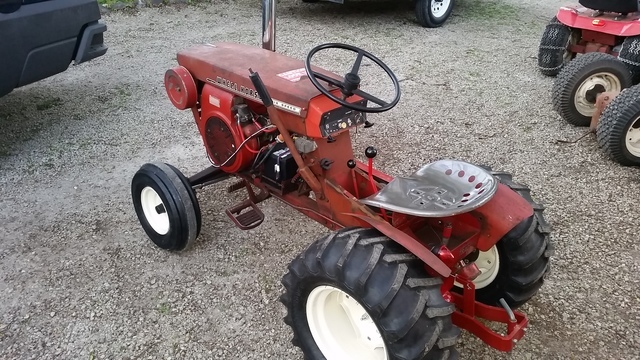

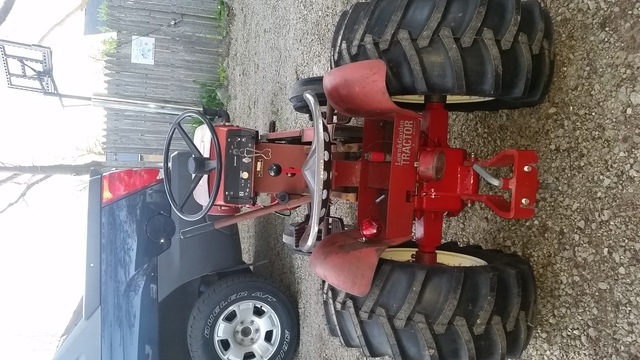

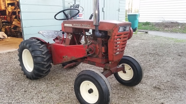

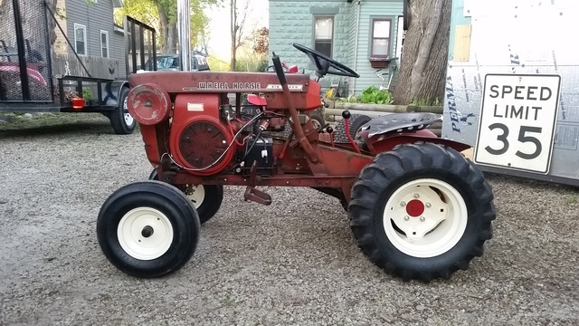

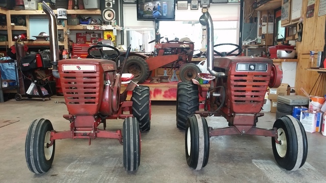

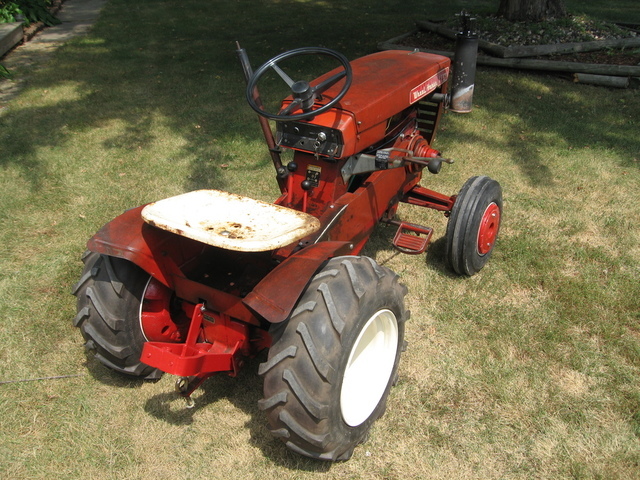

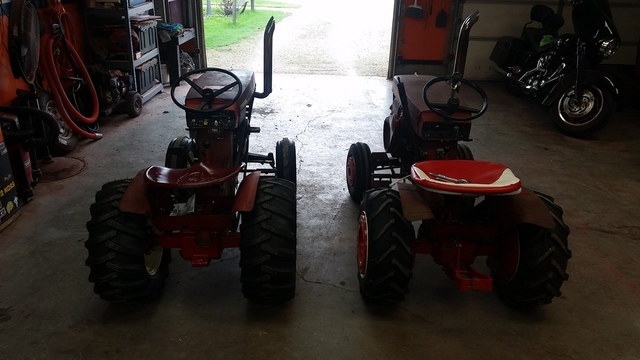

prondzy 3,889 #1 Posted May 5, 2016 Well I thought i would share some pics of my tractor I built for plowing (moldboard not snow). I just got my first putt around the yard tonight. I still have some minor things to add especially my wheel weights. It started it's life as a 1056, I replaced the 3 speed with an 8 speed trans, tightened up the steering shafts, replaced the front axle pin and beefed up the tierods with a set of adjustables from @wheelhorseman1000 . I pulled the 10hp starter/Gen motor and put on a rebuilt k341 16hp. Modified the tower to meet up with the lawn ranger toolbox/fenders. And put on a hood I had laying out back. She's sporting firestone flotation 23x10.5-12 in the rear and firestone 16-6.5x8 tri ribs on the front. 18 Share this post Link to post Share on other sites

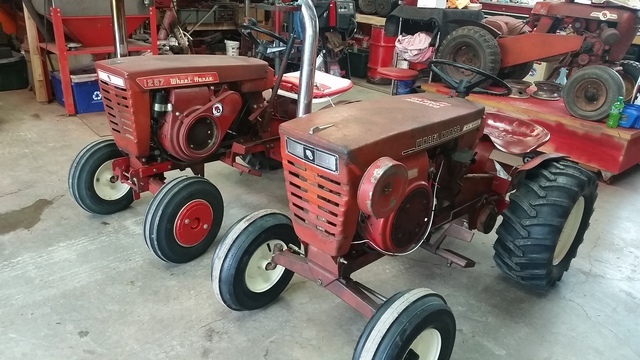

Shynon 7,543 #7 Posted May 5, 2016 Hmmm quite a resemblance you have there. 6 Share this post Link to post Share on other sites
prondzy 3,889 #8 Posted May 5, 2016 .... yeah I suppose yours looks like mine 8 Share this post Link to post Share on other sites
Shynon 7,543 #9 Posted May 5, 2016 2 minutes ago, prondzy said: yeah I suppose yours looks like mine 3 Share this post Link to post Share on other sites
