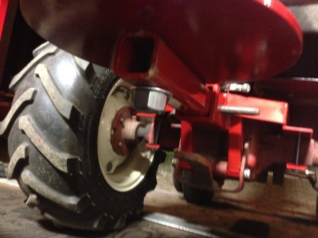

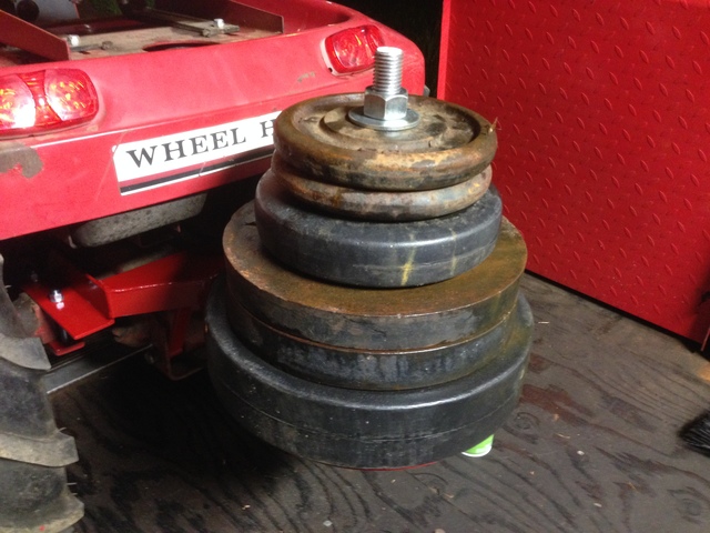

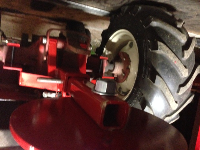

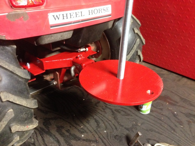

formariz 12,352 #1 Posted May 4, 2016 I got my new hitch and weight carrier from fellow member n1defan. Awesome workmanship and precise fit . This thing is really well built . Thanks Tom. 9 1 Share this post Link to post Share on other sites
857 horse 2,588 #2 Posted May 4, 2016 Should have been an option ,,,,,they missed a good idea It waited for us thanks again TOM !!!!!!!!!! 1 Share this post Link to post Share on other sites
Retired Wrencher 6,168 #3 Posted May 4, 2016 Nice looking hitch. Is this for Blowing or Plowing?= The weight. Share this post Link to post Share on other sites
Amcwheel85 2,059 #4 Posted May 4, 2016 (edited) That is sweet!! When is he taking orders?? Lol Edited May 4, 2016 by Amcwheel85 Share this post Link to post Share on other sites
WHX?? 53,328 #5 Posted May 4, 2016 That is nice .. could move bigger trailers around with that! Not as good as standing on my head as you tho! Would work good with one of these 2 Share this post Link to post Share on other sites
DougC 2,643 #6 Posted May 4, 2016 Thanks formariz. Now I think I need 2 of them and 2 sets of rear AG tires............ Share this post Link to post Share on other sites

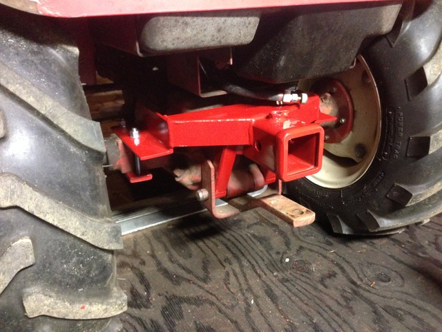

Lee1977 7,456 #9 Posted March 5, 2020 9 hours ago, SALTYWRIGHT said: I HAVE HAD ONE FOR YEARS. NOTHING AS GOOD AS THEM OUT THERE. Here is one just as good, might not be as pretty. 3 2 Share this post Link to post Share on other sites
SALTYWRIGHT 861 #10 Posted March 5, 2020 THAT LOOKS GOOD. I HAVE NEVER SEEN ONE LIKE THAT. WHO MADE IT ? Share this post Link to post Share on other sites
Lee1977 7,456 #11 Posted March 8, 2020 On 3/5/2020 at 5:52 PM, SALTYWRIGHT said: THAT LOOKS GOOD. I HAVE NEVER SEEN ONE LIKE THAT. WHO MADE IT ? I did. It's just two pieces of 2" x 2" x 1/4" angle with a piece of 3/8" x 3" flat welded between with two 3/8" x 1" braces. With a 6" long 2" receiver welded to it. I also midified the clevis hitch to work with it. Share this post Link to post Share on other sites
