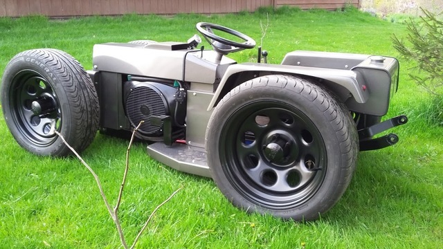

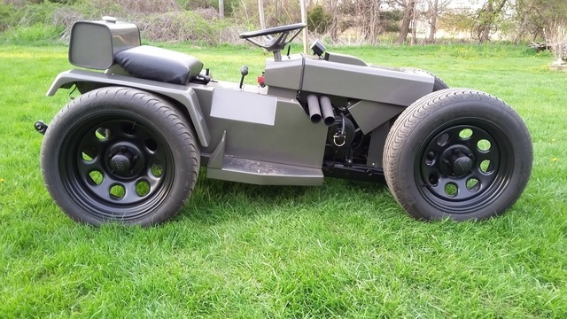

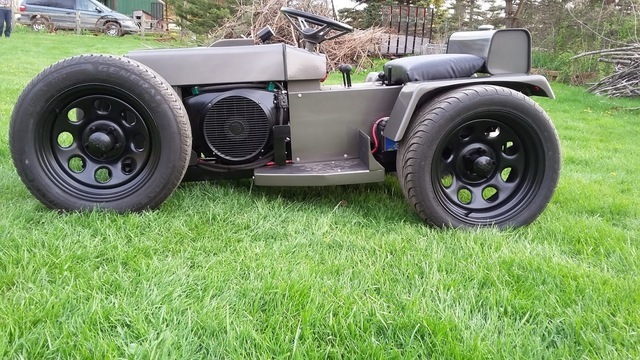

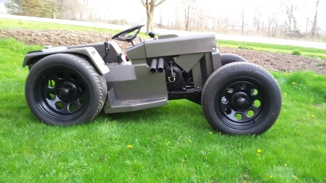

whlpny 203 #1 Posted May 4, 2016 (edited) Last year after the WheelHorse Collectors club show in PA the club made the announcement that "Customs" would be the feature tractor for the 2016 show. Man was I bummed that I had sold the Rat Grenade. First thought was to build a copy of it or to buy it back. I really hate to duplicate some projects and ruin their originality though sometimes it happens. After some thought and a suggestion by my friend Terese Emmory LaPree- I formed a new plan. At first the suggestion didn't... interest me but the following day it sparked an idea. So thanks Terese!!! This idea of a project rolled around for a couple months and I bounced it off a couple friends and they seemed to like it so I decided it had merit. I have to give some serious credit to Kevin Townsend for his help in some of the chassis design. No doubt after a couple failures into the project he was most likely getting sick of my texts for help! He added his ideas to mine for the creation of this project so my Thanks goes out to him as well! Also Thanks to Michael Biser for supplying a custom built 8-speed that gave us some flexibility in the width of the tractor. Also Thanks to Lonny Eskridge for the D-series pcs involved.This is one of 3 custom projects that we will be bringing to PA in June. So I guess here it goes- Fellow WH enthusiasts here is what has been dubbed as D-Rod Its specs are as follows- 16hp Onan Performer, Biser WH 8-spd, 4 gpm pump,power steering,hyd 3 pt hitch,16in front rubber ,17 in rear rubber on BlackRock wheels. Chassis, body and driveline all 100% handmade with exception of the D-series grille shell and front inverted axle. D-Rod can also do a couple tricks-but I will show them in another post later Edited May 5, 2016 by whlpny 29 1 Share this post Link to post Share on other sites

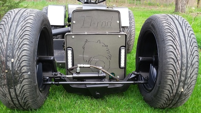

19richie66 17,763 #16 Posted May 4, 2016 So I have had drool all over my screen for most of the day staring at this thing. I was wondering what tachometer you were using and what's the deal with no axle tubes? This thing is awesome. I appreciate the time and effort it takes to restore one of these machines but this is what its all about for me. I have always had a thing for street rods since I was a kid. Out of the park Bob! I need more pictures....... 3 Share this post Link to post Share on other sites

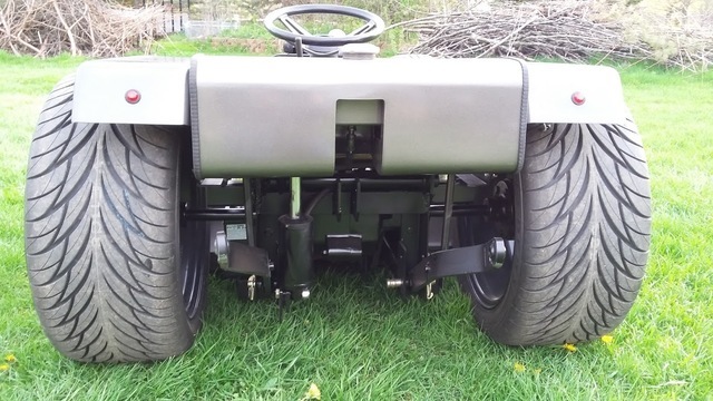

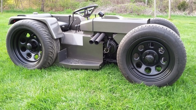

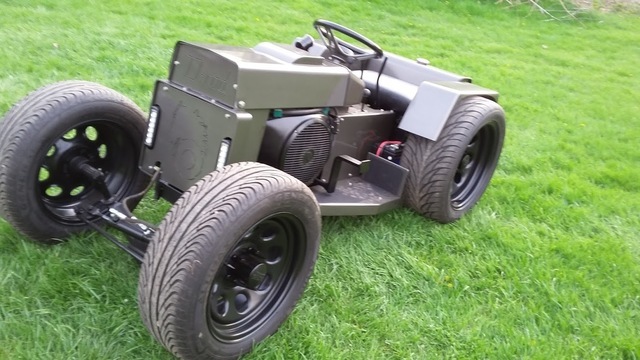

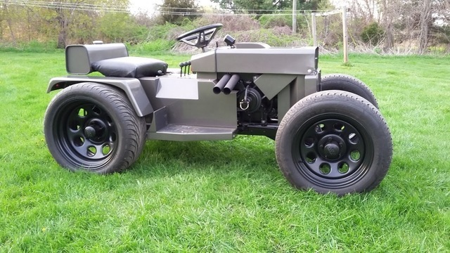

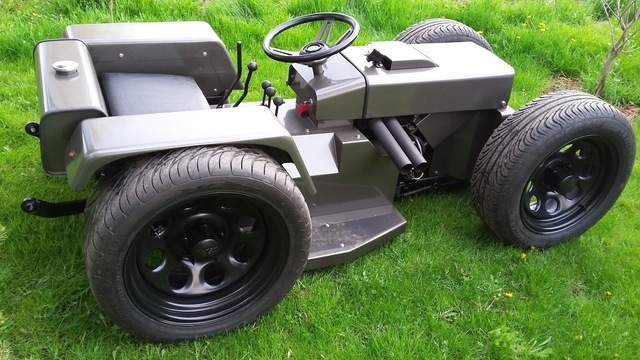

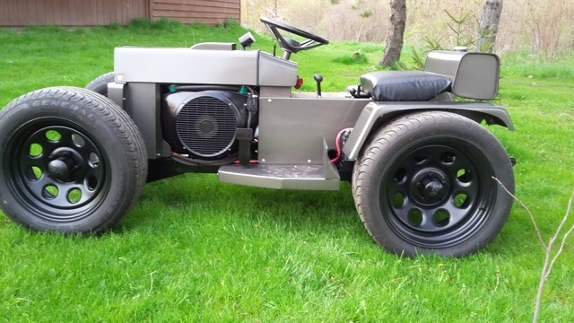

whlpny 203 #20 Posted May 5, 2016 So back to D-rod- After the Rat Grenade I learned that real low is too low when it comes time to load on a trailer. The first idea was simplifying that issue as I needed D-Rod to load into my truck bed but still be way low cool. I decided to make the front end rise with a hyd lift to get some good ground clearance and let it go up ramps. This is where it got ugly but cool ugly! Kevin Townsend hears this plan and then adds "you need to make the rear of the frame go up also". Y...up- here we go now we had brainstorming goin on. I already had planned on the 3 pt hitch and the PS so hyds wasn't an issue. So here we are the front lift gives the old Gasser look of the 60"s , the rear can lift separately for the low front rake Hot Rod look, and we can raise the tractor completely so when asked why a 3 pt ???Well why not it can go in a field with ground clearance smile emoticon Also Tach is a Summit tinytach, as for tires/wheels-wanted tall as possible in front to match hoodline and to be level with rear fenders at lowered ride height thus a smaller rear. 5 Share this post Link to post Share on other sites
