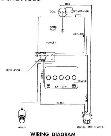

Horseplay82 14 #1 Posted May 2, 2016 I got my 1968 commando 8 running with my booster pack have and as soon as i took the leads off the engine died, what could be my problem? Share this post Link to post Share on other sites
"D"- Man 827 #2 Posted May 2, 2016 I would assume you that you opted to use the booster pack to start the engine, because the battery was either too low or dead. If so, this could be because the starter / generator was not putting out any current to recharge the battery. If the s/g is working correctly I think it should be able to power the spark + {while the battery is disconnected,} if it can't it may need serviced or replaced. Share this post Link to post Share on other sites
953 nut 63,904 #3 Posted May 2, 2016 If the battery is bad, the S/G may not be able to provide 12 volts to the ignition, or you could have bad or corroded cables or terminals that prevent the voltage from getting to the coil. Have the battery load tested and clean and tighten all electrical connections. 3 Share this post Link to post Share on other sites
pfrederi 19,773 #4 Posted May 3, 2016 (edited) If the battery is really shot it may be drawing off so much current there isn't enough left to get 12v at the coil. Also the connection of the green wire to the battery + may be bad. Current from the genny (Green wire)has to get to the ignition switch. Edited May 3, 2016 by pfrederi Share this post Link to post Share on other sites
Horseplay82 14 #5 Posted May 3, 2016 My green wire going to the pos terminal cable to the batter came out just now I wonder if that my problem Share this post Link to post Share on other sites
pfrederi 19,773 #6 Posted May 4, 2016 18 hours ago, Horseplay82 said: My green wire going to the pos terminal cable to the batter came out just now I wonder if that my problem Could be certainly wouldn't help things. Have you charged up the battery, or tested it, or swapped it with another one?. A really dead battery will cause problems even if the green wire is connected. Share this post Link to post Share on other sites
Horseplay82 14 #7 Posted May 9, 2016 I had it running yesterday with a battery in it and it seemed to me like when the battery got low enough it would quit and not fire back up but yet would still turn over Are there rebuild kits available for the Delco Remy starter generator? Share this post Link to post Share on other sites
