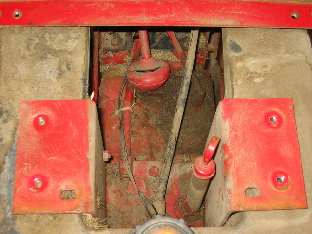

pfrederi 18,856 #11 Posted May 2, 2016 There is no seal just a shifter boot. Many have dried out and torn like this one. What does yours look like?? The t5rnny only has about 2.5 qts of oil in it (about 2" at the bottom. It gets flung around by the gears but leaking out the shifter hole would be very very unusual unless it was grossly over filled or your shifter boot was in bad shape/missing. Share this post Link to post Share on other sites
howell1000 35 #12 Posted May 2, 2016 no boot at all i have one on the way the key was broke who ever had it before me filed a bolt down and used it so i have the key and hex nut and boot on the way is there anything im missing?? Share this post Link to post Share on other sites
pfrederi 18,856 #13 Posted May 3, 2016 That should do it. the key as you call it is really a dog point set screw.... Share this post Link to post Share on other sites
