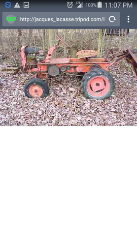

Achto 29,888 #1 Posted April 29, 2016 (edited) So I wanted a Wheel Horse for a while, then I got one. One is good right? Well one soon turned into four. I'm fine, only gonna collect made be fore 1968, I have control of this. Then I found this tractor and had to have it. This tractor thing is not an addiction, is it? What I brought home is a McLean Husky made in Indianapolis some time around the 50's or 60's. Not sure on the year, there is not a lot of info on these machines. I did read that McLean was acquired by Wheel Horse, but I don't know if this info is accurate or not. This thing is in really bad shape and has been altered by a previous owner. I'm really hoping that I can find enough info to get this thing back in shape. I'm thinking this project will quite an challenge. Below is the transmission. From what I've read it should be belt drive to the transmission, the trans consists of a selector for different chain drives 2 speeds or a reverse gear set to a chain drive. Then belt drive on each side back to a sprocket then finally chain drive to each rear wheel. This really doesn't leave a differential for the drive wheels, to accomplish that they ran rods from the steering to the tension pulleys for the post transmission belts to loosen the belt on the inside of the turn. Complicated but sounds like it would work, hopefully I can make it work. I'll start a new thread on the restoration once I get started on it. If any one has any info or pics of one of these, I would be extremely grateful! Edited April 29, 2016 by achto 8 2 Share this post Link to post Share on other sites

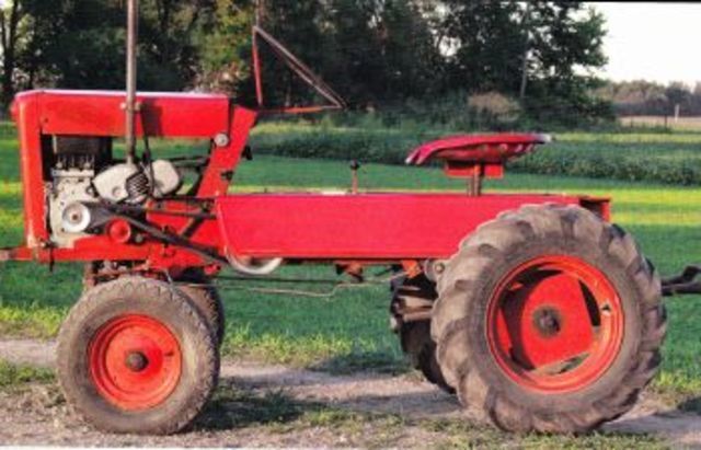

Derek M 27 #4 Posted April 29, 2016 This should help best i could find. 3 Share this post Link to post Share on other sites
rustyoldjunk 127 #5 Posted April 29, 2016 http://www.tractorfriends.org/lawngardentractors/mccleangardentractors/mccleangardentractors.html 5 Share this post Link to post Share on other sites

Achto 29,888 #7 Posted April 29, 2016 (edited) 11 hours ago, Derek M said: This should help best i could find Thanks Derek I had not found this sight. 11 hours ago, rustyoldjunk said: 4 hours ago, KC9KAS said: Very interesting reading....Thanks! Thanks guys, this site has the most pics of one of these that I have found. Hopefully my eyeball micrometer is calibrated close enough to get the pulleys and sprockets all the right size from the pictures. A P.O. removed the post transmission belt drives and put in a live axle in the rear. I want to put it back to its original design. I for see a lot of fab and machine time being put into this one. My largest concerns are finding new gears for the reverse shaft and getting the shift rail to operate properly. Edited April 29, 2016 by achto 1 1 Share this post Link to post Share on other sites
