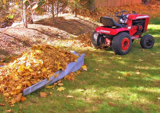

AMC RULES 37,234 #3 Posted April 25, 2016 I have a steel 520 fender pan on this one. Share this post Link to post Share on other sites
