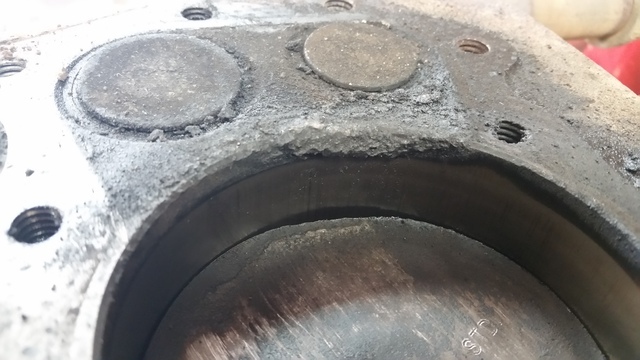

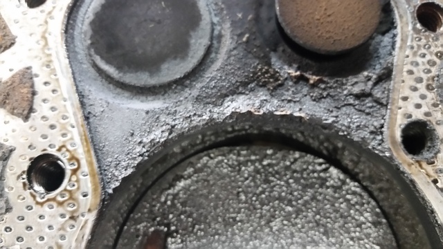

Shynon 7,505 #1 Posted April 24, 2016 Thought I would share this picture. Building a Kohler for a friend. Pulled the head and found this. Piston top was eaten away from the carbon buildup at the top of the cylinder. This is one of the reasons I pull the head on any new to me/used tractor I get you never know what you will find. 4 Share this post Link to post Share on other sites
oldredrider 2,553 #2 Posted April 24, 2016 Pulling the head and discovering what's inside is like an autopsy. It can give you insight into not only what's wrong, but the kind if life it's led. 6 Share this post Link to post Share on other sites
prondzy 3,889 #3 Posted April 25, 2016 Boy I sure wouldn't take that thing plowing, imagine the damage ! 2 Share this post Link to post Share on other sites
WHX?? 53,369 #4 Posted April 25, 2016 22 hours ago, oldredrider said: Pulling the head and discovering what's inside is like an autopsy. It can give you insight into not only what's wrong, but the kind if life it's led. Yeah kinda like that tv show where they look at bones and tell ya whats going on!! Interesting that the carbon trail leads to the exhaust valve and from the top it looks like the wall it out of round there...maybe an optical delusion tho...Could this have running a little lean? Isn't there was a tool out there for removing ridges from the tops of cylinders? 1 Share this post Link to post Share on other sites
oldredrider 2,553 #5 Posted April 25, 2016 Yup. Interestingly enough, it's called a ridge cutter! 1 Share this post Link to post Share on other sites
