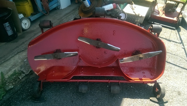

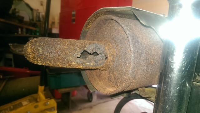

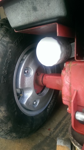

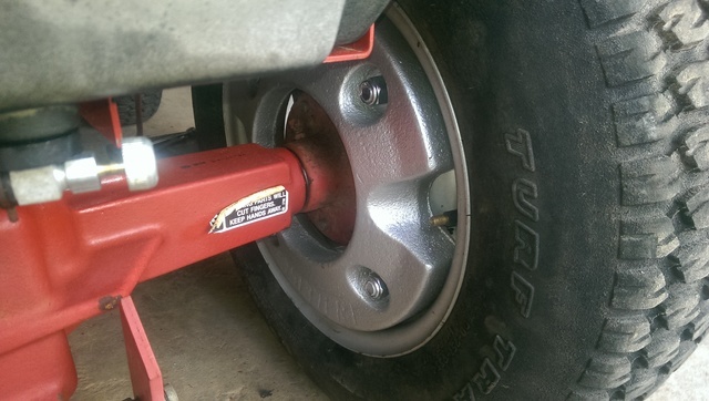

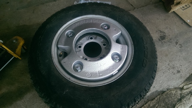

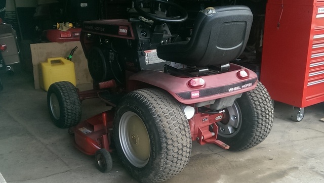

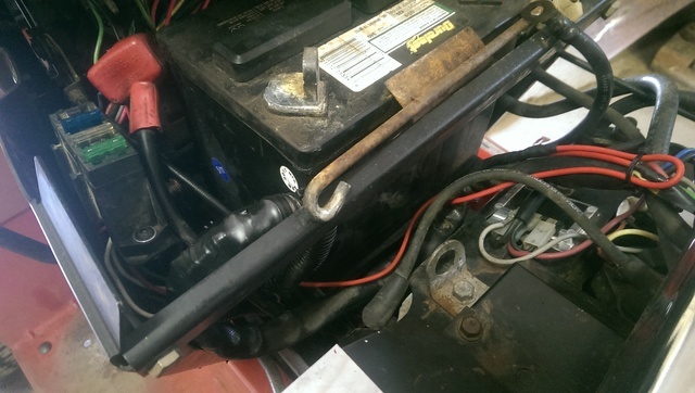

WVHillbilly520H 10,379 #26 Posted May 7, 2016 (edited) Today was very productive got all the wiring buttoned up, wheel weights installed with the plastic anniversary wheel covers from my '97, mower deck washed scraped and bottom painted and a little touch up on the top(till I get more time to do a better job), engine oil and filter changed with new rubber seal installed, new spark plugs installed, and new belts on deck spindles and PTO drive, installed sharp spare blades from my other deck (until I get the correct new ones), put hydro drive belt cover back on and hung the deck now patiently waiting on the new clutch/neutral switch to get here to install and this stallion is ready to mow some terra firma, 520 ready and a diesel to go, ... Almost forgot need to fix the muffler spout/elbow too but I don't believe it'll hurt too much to run as is for now (one would think working in a major North American aftermarket exhaust factory I could find a suitable replacement but we don't seem to make mufflers or pipe that small lots of components coming in from overseas these days), Jeff. Edited May 8, 2016 by WVHillbilly520H 1 Share this post Link to post Share on other sites

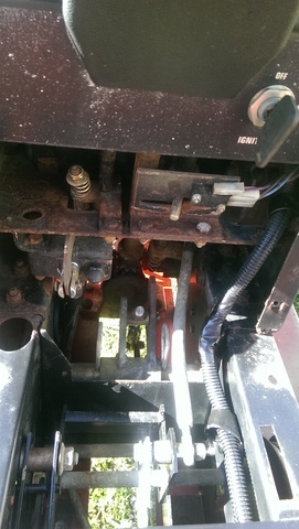

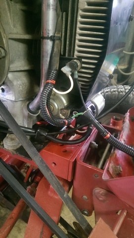

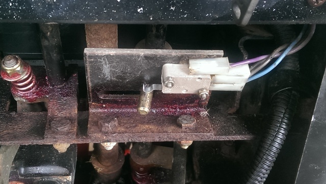

WVHillbilly520H 10,379 #27 Posted May 9, 2016 Well the switches showed up today, installed and I mowed for 2+ hrs this morning all in all this 520 was worth the $1200 + parts and "sweat" labor and head scratching, ran smooth and never bogged down in 8" wet grass this project is done (except the muffler spout) till I decide to paint or not , and pics of before and after neutral switch couldn't believe I missed that for weeks trying to track down an electrical problem vs a simple mechanical one, oh well it's fixed now,Jeff. 1 Share this post Link to post Share on other sites

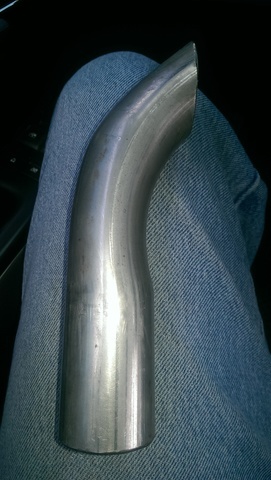

WVHillbilly520H 10,379 #28 Posted May 13, 2016 Made to a custom exhaust shop today, really cool guy, bent and cut a piece of 1.5" tubing (for free ) for the muffler spout on the 520 now to get it on there I think I can handle that,Jeff. 1 Share this post Link to post Share on other sites

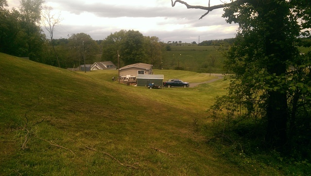

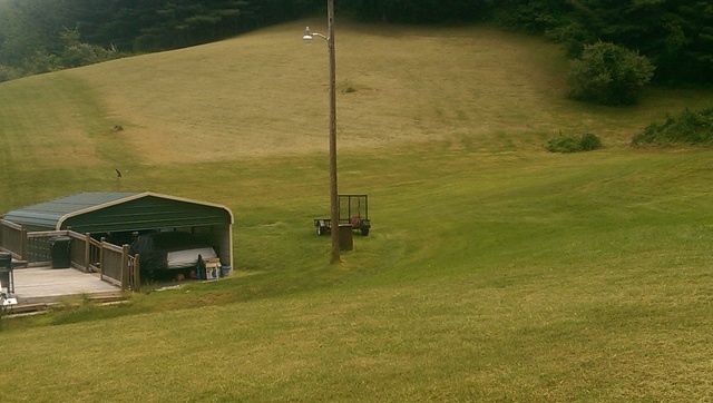

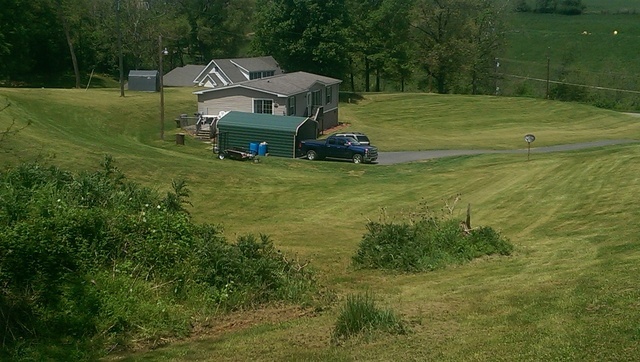

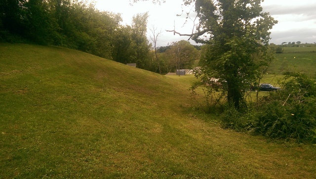

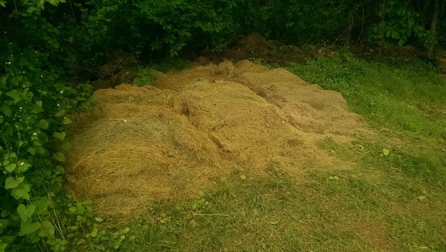

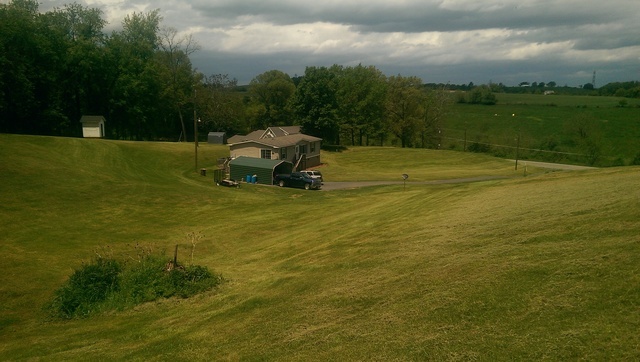

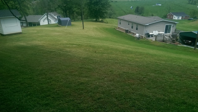

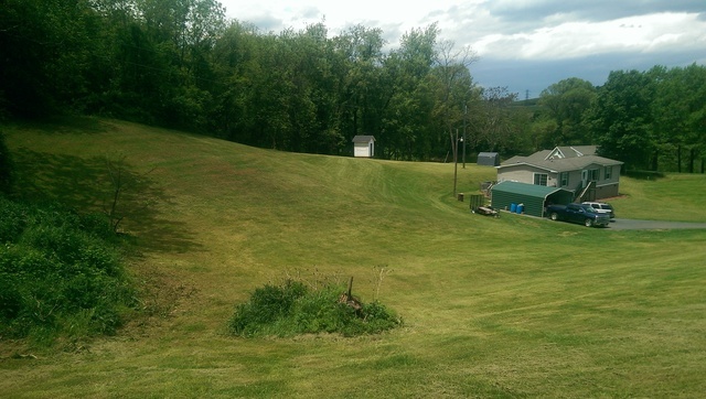

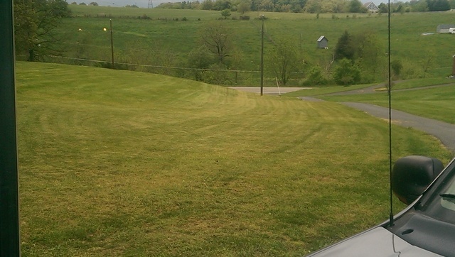

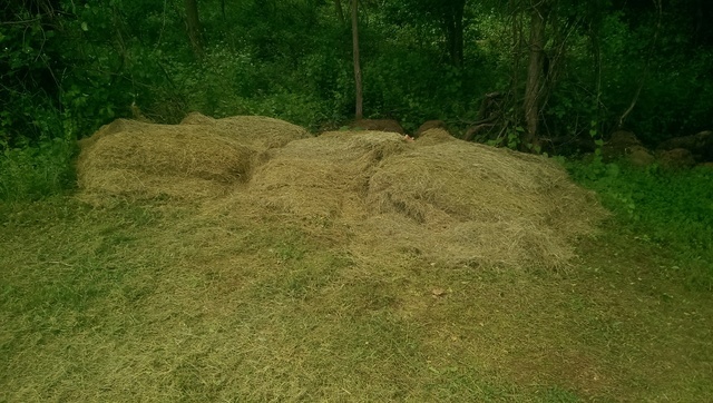

WVHillbilly520H 10,379 #31 Posted May 14, 2016 Ok after about 7 hrs on this horse, I think I finally got the yard in decent shape, but that Simplicity seat has to go it doesn't have slider tracks and I'm not to happy with the turf tires on my hilly lot, also the mule drive has a bad bearing noisy and by the time I got done today burned up my cheap aftermarket PTO belt (the grass was 8"-10" tall tough and wet my bad for letting it get that way) (been mowing #5 highest setting but still lower than my F-I-L's Kubota ZTR) but I have the one from my '97 till I get that fixed but the deck is super quiet, well anyways a few shots of the "aftermath" of mowing and sweeping lol,Jeff. Pic #8 down is what my F-I-L leaves after mowing I usually have to "bale" up his "hay" as well as mine, he doesn't get it that leaving it lay just makes it worse to now the next time I think that helped burn PTO belt up trying to remow his grass mat,. 1 Share this post Link to post Share on other sites
TDF5G 2,074 #32 Posted May 16, 2016 Your place looks great. You don't have a basement do you? Looks like you'd get water in the basement when it rained a lot. 1 Share this post Link to post Share on other sites
WVHillbilly520H 10,379 #33 Posted May 16, 2016 2 hours ago, TDF5G said: Your place looks great. You don't have a basement do you? Looks like you'd get water in the basement when it rained a lot. THANK YOU SIR,No basement wish we did then I would probably have ALL my 's hiding in there lol, if I hadn't been so stubborn about leaving the cab and 2 stage on my '97 520 I probably wouldn't have had the trouble mowing so late but oh well, and her step-dad does help but that Kubota just doesn't mow as low as the horses on high...but come end of summer plan on putting another carport up where the gray shed in a box is behind the house for the herd,Jeff 1 Share this post Link to post Share on other sites

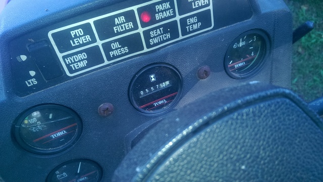

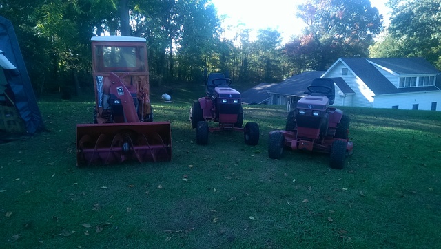

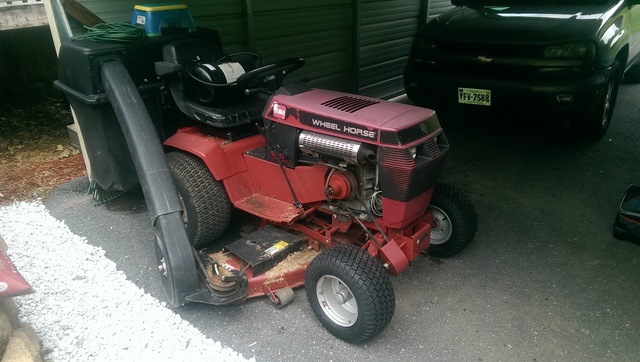

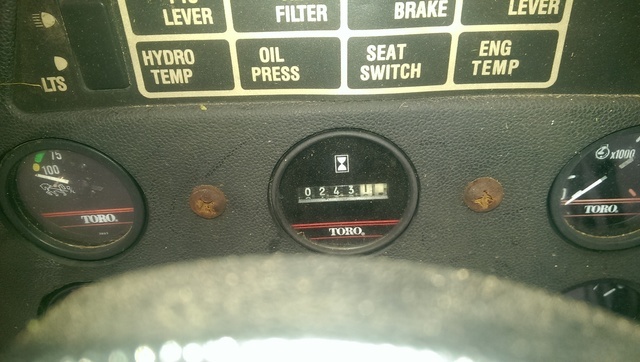

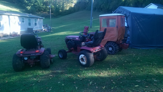

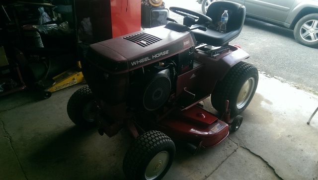

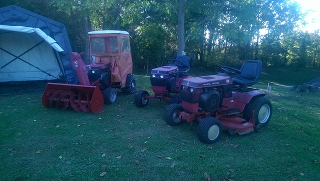

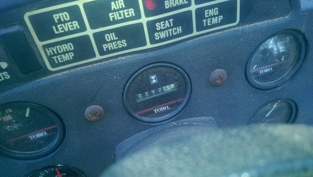

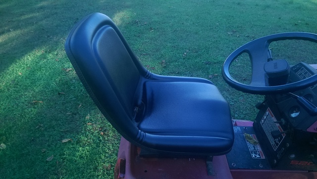

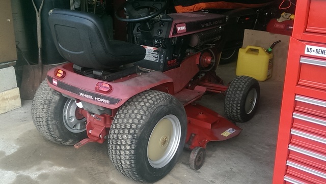

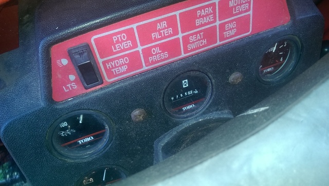

WVHillbilly520H 10,379 #34 Posted October 17, 2016 (edited) Figured I would post an update on this horse since getting it back up to working condition, only 1 problem during the mowing season fuel pump went bad got one on eBay from "Flip MFG" same as the Onan but 2-3 for the price of 1, also bought a new seat from Northern Tool basically the O.E. from TORO for $120 to the door, after all this mowing this spring/summer clocked from 236-292 hrs now,all in all I believe it's been well worth the $1200 plus I have invested so far, also bought a third 520h 557 hrs with bagger attachment that needed new front tires for $1000, and my anniversary with 755hrs, had them all out today and running, now to fix that diesel,Jeff. VIDEO0056.3gp Edited October 17, 2016 by WVHillbilly520H add pics 4 Share this post Link to post Share on other sites
