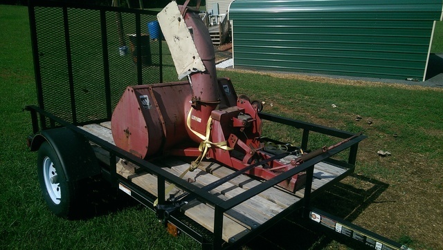

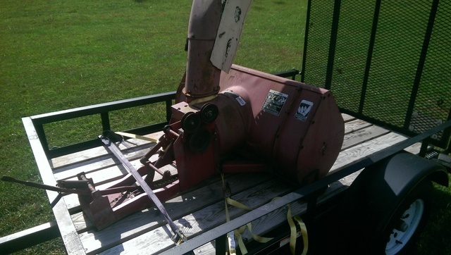

Chuck... 83 #34 Posted April 19, 2016 28 minutes ago, Aldon said: Glad your not near me geographically. I would be tempted to try and acquire one of your refurbished beasts! Lol your doing a thorough job! It will be for sale shortly. 60 inch deck and 44 inch 2 stage snowblower. Not sure about the cab yet if I am going to keep it. But the snowblower is in really nice shape. 2 Share this post Link to post Share on other sites

WHX?? 56,842 #38 Posted April 21, 2016 (edited) Cleaned up real nice Chuck.... I would certainly be interested in that blower if it would fit up to a 520H but I don't think it will. Does look to be in really good shape....maybe just have to come get the whole tractor from ya!! What oil are you using in the hydro? Edited April 21, 2016 by WHX61/3 Share this post Link to post Share on other sites

Chuck... 83 #43 Posted April 21, 2016 6 hours ago, WHX61/3 said: Cleaned up real nice Chuck.... I would certainly be interested in that blower if it would fit up to a 520H but I don't think it will. Does look to be in really good shape....maybe just have to come get the whole tractor from ya!! What oil are you using in the hydro? Thanks I am pleased so far with it. The guy on ebay that I bought it all from says that his buddy bought out a toro dealer and the snowblower that I bought was new in the box. But it was for the 520h he said the dealer modified it to fit on the 5xi they did a pretty good job I think. But the snowblower it's self only has like 1 winter on it that's what the guy said but it looks like it's in good shape. It will be for sale soon. I just used what the owners manual said to use for the hydro regular 10W30 Thanks for looking Share this post Link to post Share on other sites
WHX?? 56,842 #44 Posted April 21, 2016 Keep me in mind as a potential buyer. 1 Share this post Link to post Share on other sites
WHX?? 56,842 #45 Posted April 22, 2016 Wadda ya think Brian @WNYPCRepair ...could be refitted to a 520H???? If not would be a shame if I had to have the tractor too!!! Share this post Link to post Share on other sites
WVHillbilly520H 10,378 #46 Posted April 22, 2016 If that 2stage was modified from a classic to an Xi they had to change a lot besides the obvious wider frame width of the Xi attach-a-matic the whole PTO belt drive jack shaft assembly is different the Xi comes out under the front grill/bumper and drives the blower gearbox straight in line, where the classic has the side PTO with a 90° Jack shaft gearbox, and of course the same modifying in reverse to go from Xi to say a 520H..maybe Chuck could post a picture of the rear/side, frame/gearbox of his Xi blower and compare to a classic style like mine,(pics before I rebuilt and painted it, don't judge P.O.'s chute wings said it kept the snow of him without a cab) just my ,Jeff. 1 Share this post Link to post Share on other sites
WNYPCRepair 1,924 #47 Posted April 22, 2016 10 hours ago, WHX61/3 said: Wadda ya think Brian @WNYPCRepair ...could be refitted to a 520H???? If not would be a shame if I had to have the tractor too!!! Yes, like Jeff said, it would not be easy to convert to a classic WH style. But, you need the tractor anyway. Share this post Link to post Share on other sites
Dennys502 246 #48 Posted April 22, 2016 The weight or mass of the wheel weights have little to do with the hubs being worn out unless you are running it with the wheels off the ground. With the wheels contacting the ground the spinning mass of the tire has very little momentum. The torque from taking off or stopping is the biggest factor. When you get more traction - then more torque is applied. The whole weight of the tractor comes into play when moving or stopping. 1 Share this post Link to post Share on other sites
Chuck... 83 #49 Posted April 22, 2016 (edited) 14 hours ago, WVHillbilly520H said: If that 2stage was modified from a classic to an Xi they had to change a lot besides the obvious wider frame width of the Xi attach-a-matic the whole PTO belt drive jack shaft assembly is different the Xi comes out under the front grill/bumper and drives the blower gearbox straight in line, where the classic has the side PTO with a 90° Jack shaft gearbox, and of course the same modifying in reverse to go from Xi to say a 520H..maybe Chuck could post a picture of the rear/side, frame/gearbox of his Xi blower and compare to a classic style like mine,(pics before I rebuilt and painted it, don't judge P.O.'s chute wings said it kept the snow of him without a cab) just my ,Jeff. You just start that restoration on that snowblower yet you or you just pick it up recently. Well he said it was alot of work. He told me that the original 5xi snowblower was rusted out bad so they saved the mounting frame and the part of the classic snowblower they used was like from the impeller housing forward. To start out this was the classic numbers Then the Xi numbers This is the classic one the hand crank is angled, the side support brackets are bolted on, and the top is different from the Xi Still the classic then on the inside you can see looks like they welded a piece of angle iron on the blower housing. Now the Xi The hand crank is mounted flat, the side support brackets are welded on Then Xi again the gears are mounted different front the converted one Anyways this is the converted one it is in pretty good shape and looms like they did a pretty good job of converting it to work on the xi. One thing I also noticed when I was comparing the 2 was the address one the model tag. The old one the address was South Bend Indiana, and the Xi was Bloomington mn I was just wondering what year they moved Edited April 22, 2016 by Chuck... Share this post Link to post Share on other sites
