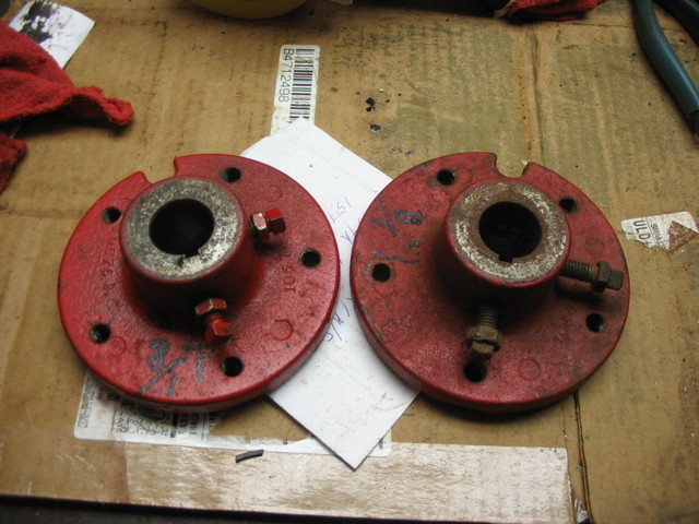

daveoman1966 3,884 #2 Posted April 13, 2016 use hub with TWO locking screws...like these. 1 Share this post Link to post Share on other sites
Ed Kennell 47,616 #3 Posted April 13, 2016 I replaced some of my set screws with socket head cap screws with lock nuts. I prefer UNBRAKOs if I can get them. 2 Share this post Link to post Share on other sites

Phatboy 566 #6 Posted April 13, 2016 (edited) Yea my hubs have 2 set screws in each hub now,, ok if they loosen up again ill try and put regular grade 8 bolts and nylon lock nuts on there and try that,,, but keep the ideas coming please... Edited April 13, 2016 by Phatboy 1 Share this post Link to post Share on other sites

Phatboy 566 #9 Posted April 13, 2016 (edited) Well i just went to lowes and got grade 8 bolts and lock nuts ,, we will do some more plowing tomorrow and see how they work .. If not ill hve to try something else..and no imnot torquing lock nuts just tighting them down with a wrench ... I torqued the bolts tho ,, manual says 28 to 32 ft lbs , but seing as they are new bolts i went to 40 ft lbs.. So we will see,, 2 hours ago, Ed Kennell said: I replaced some of my set screws with socket head cap screws with lock nuts. I prefer UNBRAKOs if I can get them. Im assuming a socket head cap screw means regular bolt lol.. Edited April 13, 2016 by Phatboy Share this post Link to post Share on other sites
