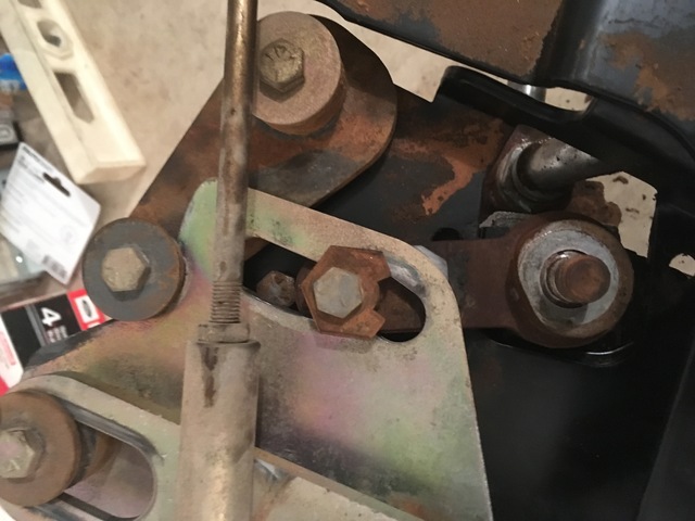

bluebug 27 #10 Posted December 30, 2016 I put it all back together and installed it back into the tractor. I found the neutral eccentric 180 degrees out of position. Clark 1 Share this post Link to post Share on other sites
