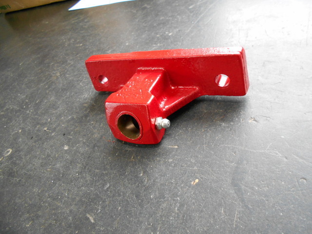

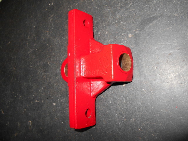

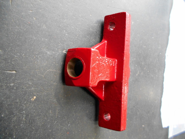

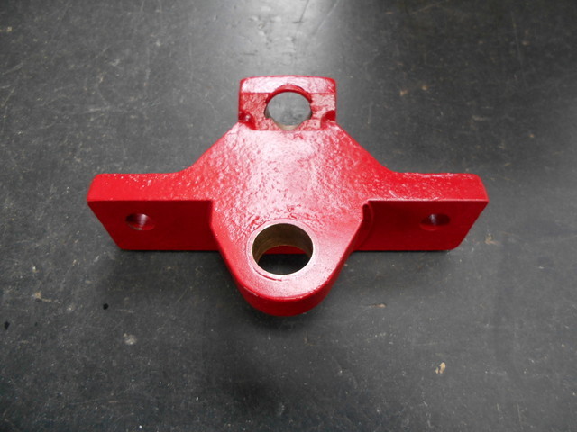

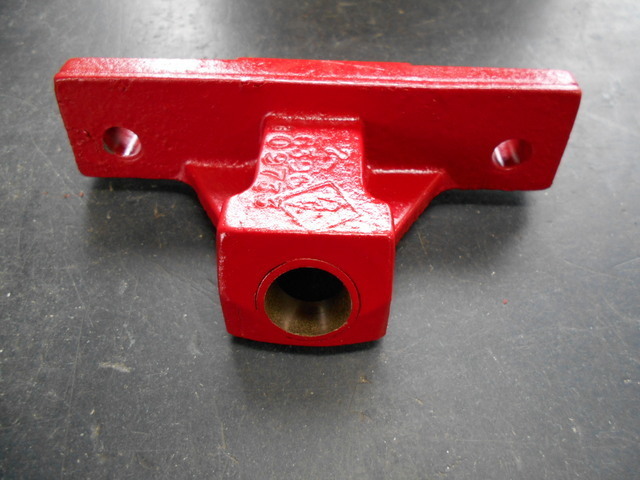

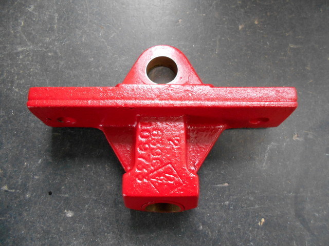

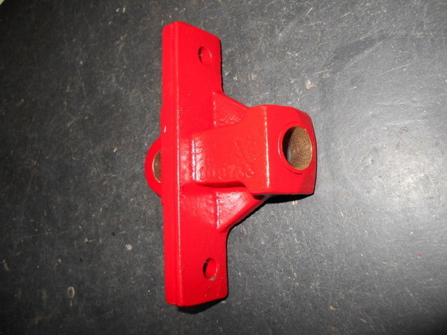

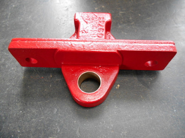

cleat 7,734 #1 Posted April 11, 2016 I have rebuilt all of my 520's steering blocks with non gear reduction steering. This should work on most Wheel Horses. I clamp the block into a drill press and drill out both holes to 7/8" then press in 7/8" x 3/4" brass bushings. I used bushings that were 3/4" long. Then cut and file to fit flush. Drill a small hole through the bushing for the grease fitting. 3/4" centers of bushings then reamed or carefully filed to fit steering shafts perfectly (after pressing in bushings the center hole gets slightly reduced). You now have a steering block that is better than new. 7 1 Share this post Link to post Share on other sites

cleat 7,734 #3 Posted April 11, 2016 I use a 3/4" reamer to finish the inside of the bushings after they are installed. This block was rebuilt last winter. I work between 50 and 60 hours a week as a Millwright at a chemical plant plus spend lots of time with my great wife and 10 year old daughter. However, I still find the time to play with my horses. 3 Share this post Link to post Share on other sites
KC9KAS 4,744 #4 Posted April 11, 2016 That is a Dandy upgrade! Thanks for the photos. Share this post Link to post Share on other sites
