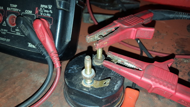

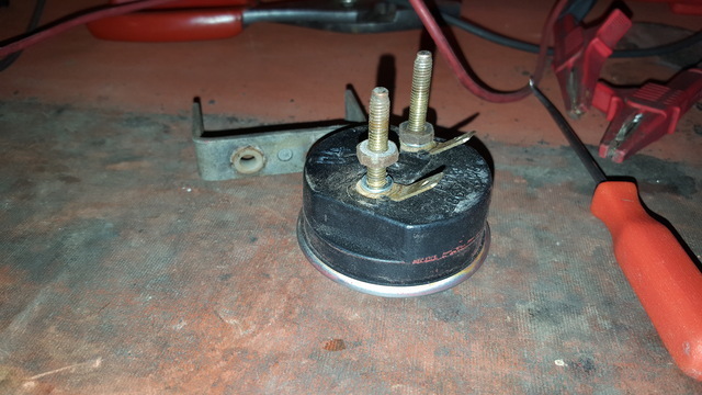

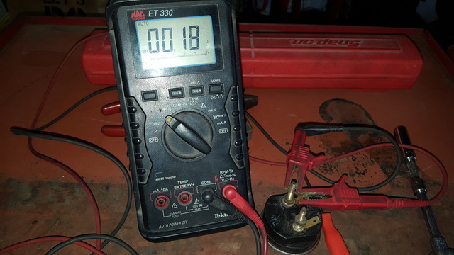

Rusty42 7 #1 Posted April 11, 2016 Hello to all! Great forum you have here! I recently picked up a 1975 B80 4spd with a charging problem. While troubleshooting the charging system I found a wire backed out of the terminal crimp at the rectifier. During the repair I noticed that the ammeter was disconnected and the 2 wires butt connected together. I hadn't notice the ammeter not working when I bought the tractor but there was no way it was gonna work like that! I tested the ammeter and found an open circuit between the positive and negative terminals. If connected, this would have resulted in a "no crank" condition. I then tested for continuity between the threaded posts the terminals are fastened to and found less than 1 ohm resistance, AH HA! I removed the ammeter and cleaned the oxidized/corroded terminal, nut, and threaded post. I reassembled using locking washers to ensure contact, tested the connection and now had less than 5 ohms resistance in the ammeter circuit. I installed the ammeter and it works like a charm!! 5 Share this post Link to post Share on other sites

Rusty42 7 #6 Posted April 11, 2016 2 hours ago, squonk said: I don't understand how you can clean the connections and end up with more resistance. Unless the corrosion was so bad it shorted the terminals together kind of like a dirty battery top? Less than 5 ohms is the spec for the ammeter circuit. Cleaning the connections repaired terminals of the ammeter. Initial testing showed infinite resistance in the ammeter circuit. 1 Share this post Link to post Share on other sites
