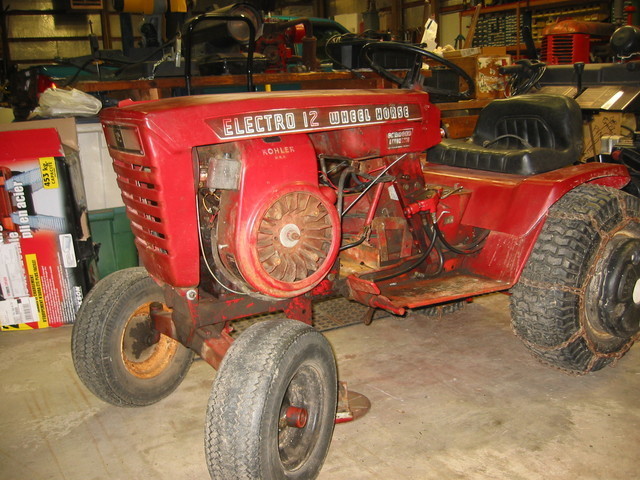

pfrederi 19,810 #8 Posted April 12, 2016 On 4/11/2016 at 6:51 AM, BenTheWheelHorseMan said: I didn't know that. Although mine has a battery and before it has been so dead that the engine will not turn over. I assume at some point it got converted to battery ignition. My rectifier is not hooked up at all. Looks like the wiring is sort of a mess. Sometime this week I will tear into it and see what I can find out to fix it. I am confused what type ignition system do you have. Battery ignition there is a round coil, breakerless there is a triangular shaped coil mounted on the engine shroud. magneto system has no visible coil. Breakerless and magneto do not need the battery to run. Picture shows the breakerless system coil Black thing just under the E in Electro Share this post Link to post Share on other sites
BenTheWheelHorseMan 43 #9 Posted April 13, 2016 13 hours ago, pfrederi said: I am confused what type ignition system do you have. Battery ignition there is a round coil, breakerless there is a triangular shaped coil mounted on the engine shroud. magneto system has no visible coil. Breakerless and magneto do not need the battery to run. Picture shows the breakerless system coil Black thing just under the E in Electro Mine is breakerless. It has the triangular coil. I also am confused as to what is going on. Does it need a battery to start? If anybody has a wiring diagram for a charger 12 it would be of great help to me. Share this post Link to post Share on other sites
