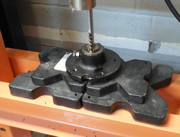

Kurt-NEPA 755 #6 Posted April 9, 2016 (edited) I did a pair of 1-1/8" hubs. I got the bushing and broach from Enco. I used the import brand and that worked just fine. DuMont was much more expensive. I forget what I paid, but it was probably about $35. My 20 Ton HF press made quick work of the job. Also, I had to drill a tap a hole for the set screw and mill a flat for the jam nut. Edited April 9, 2016 by Kurt-NEPA 4 Share this post Link to post Share on other sites
Kurt-NEPA 755 #7 Posted April 9, 2016 Found a picture from when I broached a keyway on a 1-1/8" hub. 4 Share this post Link to post Share on other sites
