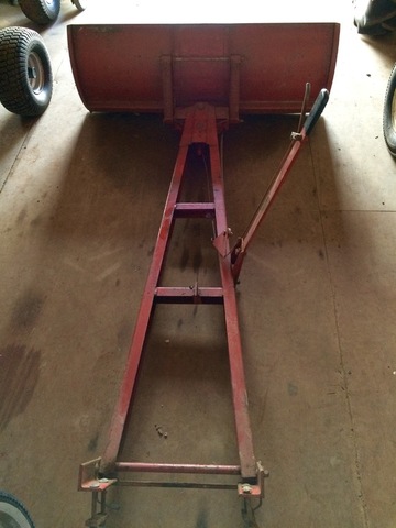

953 nut 59,282 #13 Posted April 3, 2016 15 minutes ago, Mike_W said: 876 manual for download, I already posted the link to your manual download earlier. 16 minutes ago, Mike_W said: some backyard engineering will be in order as he has no other hardware. Take a look at the rear axle, there should be a bracket attached to it that the pivot pins will clip into. All you need then is a flat bar from the sleeve hitch and a piece of chain or a rod to attach the two. The bracket will look like the one at the bottom of this photo. 2 Share this post Link to post Share on other sites
