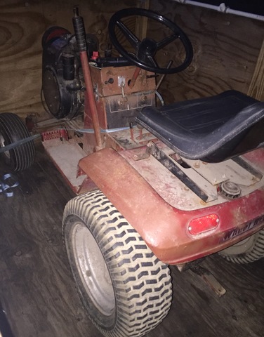

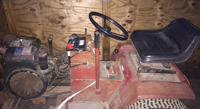

Aldon 4,834 #6 Posted April 4, 2016 2 hours ago, SylvanLakeWH said: Good to know that you can say truthfully: "No C 105's were killed in the making of this genetically modified GT 14..."! So I pulled the trigger. Thought about posting in mirror thread but this partial tractor won't be resurrected. No hood or attachments and probably other stuff misusing but motor cranks, does not charge, has 8 speed and attach-a-matic hardware and frame that I need. Not much will go to waste. I'll probably snag the parts I need and post the remainder for sale on the pre-show sale thread. 1 Share this post Link to post Share on other sites
SylvanLakeWH 32,823 #7 Posted April 4, 2016 RIP little C-105...From the looks of it you are definitely not ... Looks like it will be a great little project! 1 Share this post Link to post Share on other sites
