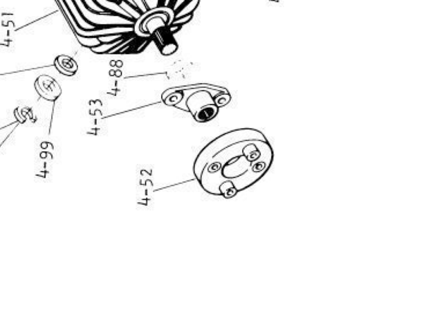

wheelhorse-c-161-1979 117 #1 Posted April 2, 2016 Howdy, I bought a new flywheel for my Auto 18. I broke the other one about a week ago when a tool fell while the engine was running and since i had no screen, I broke all the fins. I should be getting my bonehead gold star anyday So I'm trying to remove the flywheel after clearing out some of the parts. But I am now stuck at the point where the coupling meets the Sunstrand tranny. I was hoping by removing the 4 coupling bolts that the coupling ( 4-53 on the image below) would fall out and then i could work on removing the flywheel. Does anybody know if I have to loosen or remove the engine to get enough space to remove the flywheel and replace it? Or better yet, what is the procedure to replace the flywheel on my engine? Thanks for the help, cause i sure need it Jack Share this post Link to post Share on other sites

pfrederi 19,771 #3 Posted April 2, 2016 (edited) Welcome to D land. You have to demount the engine and slide it ahead. Then you will probably have to rotate it 90 degrees to get enough space to get a puller on the flywheel. When you put it back you have to make sure the engine and hydro pump are perfectly aligned there is a rather detailed TSB on the topic. Sorry Nothing on a D is simple. Incidentally the Sundstrand hydro manual actually gives good instruction on how to remove the engine, (page 27) Edited April 2, 2016 by pfrederi 1 Share this post Link to post Share on other sites
wheelhorse-c-161-1979 117 #4 Posted April 2, 2016 34 minutes ago, pfrederi said: Then you will probably have to rotate it 90 degrees to get enough space to get a puller on the flywheel. When you put it back you have to make sure the engine and hydro pump are perfectly aligned there is a rather detailed TSB on the topic. Sorry Nothing on a D is simple. Incidentally the Sundstrand hydro manual actually gives good instruction on how to remove the engine, (page 27) Hello again prefrederi! When i remove the engine, is there wiggle room when i put it back, or does it go back and line up perfectly where the bolts were? As for removing the flywheel. Is it screwed in? and what kind of puller do I need? It looks like there are holes for 4 bolts to hold the flywheel, but i don't know if will slip off or will take a puller. Meanwhile, I will dig in to the sunsrand manual and see if I can see a flywheel breakout. It woulda been just too easy to slip it off by removing the coupler, lol! "no good deed goes unpunished!" Thanks, Jack Which Sunstrand manual are you referring to regarding engine removal? I have Sunstrand Hydro Part 1 2 3 and 4, and don't see any references. Meanwhile, I'll keep looking to see if there is another I can download. Thanks Jack' Share this post Link to post Share on other sites

pfrederi 19,771 #6 Posted April 2, 2016 The sundstrand manual here covers engine removal as it is necessary to get to the pump. http://www.wheelhorseforum.com/files/file/24-transmission-hydro-sundstrand-sm-492-4206pdf/ the engine slides into the pump coupler. After you get the engine loose you can slide it forward and the splined coupler will separate. I would carefully mark the frame before you move the engine so when you put it back you can be in good alignment. you should still check it however. misalignment will screw up the splined coupler. The harmonic balance puller mentioned above would be a good way. There are threaded holes in the flywheel to pull on. 1 Share this post Link to post Share on other sites
