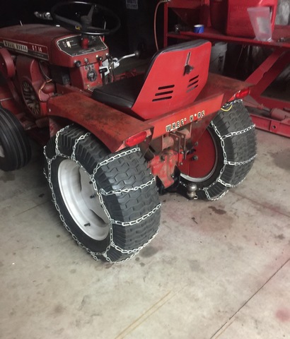

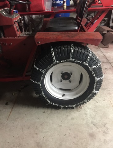

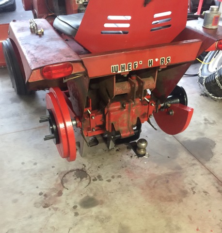

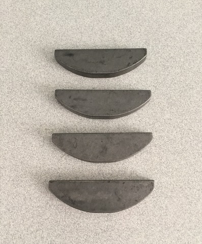

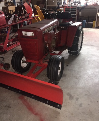

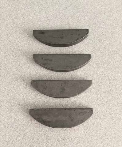

Aldon 4,832 #54 Posted October 12, 2016 (edited) Well Lazarus got some wheel weights, chains and a snow plow. New axle seals and woodruff keys as well. Figured I would just update it on the his thread. Edited October 12, 2016 by Aldon 1 Share this post Link to post Share on other sites

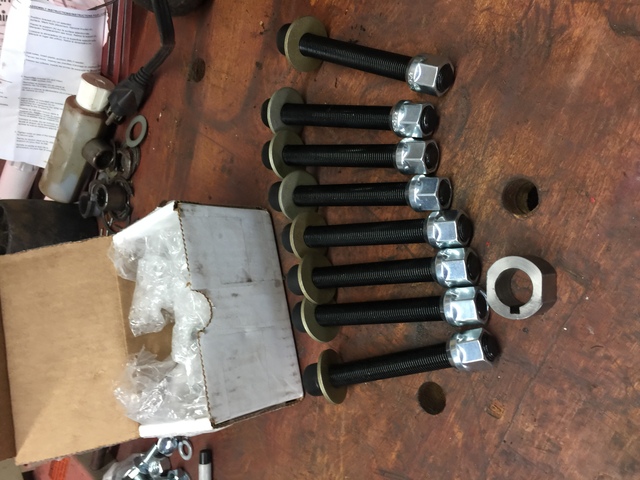

ztnoo 2,302 #55 Posted October 13, 2016 Looking pretty spiffy there, Mr. T!!! How much do the weights add? btw where did you locate your bolts??? 1 Share this post Link to post Share on other sites
Aldon 4,832 #56 Posted October 13, 2016 (edited) Did not bother to weigh them. They are heavy. And a royal PITA to install on the backside as they were intended. A task I don't wish to repeat often. As for the bolts, my bud Rick in Osceola got them for me. He did not articulate where. And they are cap head bolts rather than standard hex. 5 inches I think. Hex head bolts of this length are just not around in fully threaded fine thread. Edited October 13, 2016 by Aldon Share this post Link to post Share on other sites
ztnoo 2,302 #57 Posted October 13, 2016 Anyone have any idea what a pair of wheel weights for a GT 14 weigh??? Now I can see why the hubs have such a long length. Share this post Link to post Share on other sites
DTOM 124 #58 Posted October 13, 2016 64lbs 12.5oz per side with nuts and bolts. 2 Share this post Link to post Share on other sites

dells68 7,499 #61 Posted October 13, 2016 Hey Aldon! Where did you get your chains and what size are they? Nice looking machine! Share this post Link to post Share on other sites
DTOM 124 #62 Posted October 14, 2016 Look for 27x8.5x15 two links. Share this post Link to post Share on other sites
