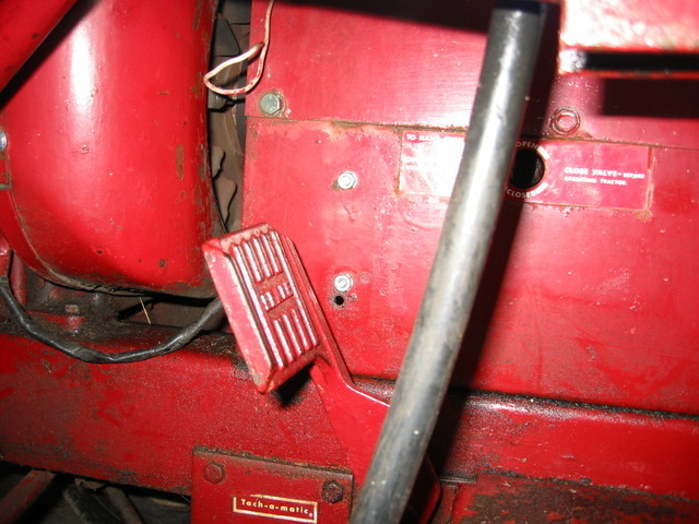

BMW1 44 #1 Posted March 30, 2016 Can someone let me know if this tractor has a hydro release lever and where it is - so it can roll freely. The owner listed the model as 106108 with a serial# of 946234 but I cannot find an owners manual in the manuals for this model. I am new to wheel horse's and will be picking the tractor up this coming weekend. I attached a picture of the tractor. Thank You. 1 Share this post Link to post Share on other sites
pfrederi 18,690 #2 Posted March 30, 2016 Look on the left side near the brake pedal. Look in the hole some use a flat tip screw driver others a hex 1 Share this post Link to post Share on other sites
pacer 3,177 #4 Posted March 30, 2016 Heh, but dont be surprised if that sucker is froze SOLID! Share this post Link to post Share on other sites
ericj 1,579 #5 Posted March 31, 2016 make sure if you have to hand push it, that you air up the tires before trying. I knoww the smaller tractors are a lot harder to push with low tires, and that out weighs a C series by a few hundred pounds. good luck and let us know how you make out eric j Share this post Link to post Share on other sites
BMW1 44 #6 Posted March 31, 2016 Thanks. Filling up and taking small air compressor with. 1 Share this post Link to post Share on other sites
